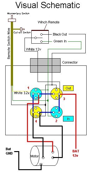

Well, everything is mounted BUT, this winch is probably 8 years old, I replaced the motor over 2 years ago and I don't think I've ever used it since. I kinda screwed up and took this whole thing apart before testing it. So I've got this sexy winch with everything mounted (including a new flatblack paintjob in the inside of my grill & some mesh that I got off the donor grill at the junkyard) only to realize that the winch is only working in one direction and seizing up in the other direction. Totally possible that this is a result of me not labeling everything when I took it apart or else a result of this sitting outside unused for 2 years.

Make sure its not just a bad solenoid. My older Ramsey had a bad "In" solenoid, and made it seem like the motor was seizing as it would not take in the cable.
Probably worth checking before buying a new winch. . .

Yeah, I purchased 2 new solenoids per recommendation of the supplier who sold me the new motor, too bad, they don't match what's in the box. I may try to use them anyway if I can match them up. The warn controller box uses 4 solenoids that are exactly like the starter solenoid on the fender wall.
Hey Paul, why don't you head on down to Truckhaven this weekend so we can compare winches.
Okay, so this is how my setup has 4 solenoids...
and the 2 solenoids I have look like this
wondering if I can convert them over. Here's proof they really are winch solenoids. http://images.google.com/imgres?img...prev=/images?q=winch+solenoid&um=1&hl=en&sa=N

The status on the winch is a bad motor, I used this test online to determine it was bad by eliminating the solenoids all together. Too bad I paid $150 for a motor that never got used but you live and learn. http://www.pirate4x4.com/tech/billavista/Q&A1/Q&A1_signed.pdf
