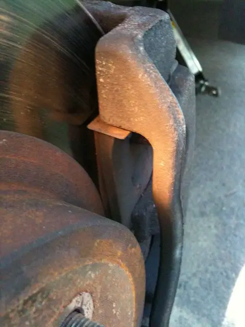

As an update to this thread, the squealing was not the belt/hose (pictured above). I finally nailed it down to the driver side wheel, and took off the wheel today. When I thought I had new brakes put in, it appears only the rear ones were done. The front pads are pretty thin, no? Attached a picture below. Rear pads are great and much thicker, which makes me believe that this noise somehow is just brakes. Going back to the shop...
Steve
Were you ever able to figure out the cause of the "squealing"? Was it just brake pads? I'm having a similar problem. Thanks.
It was a stuck caliper...remember to replace both sides at the same time or it will come back to bite you!
