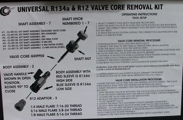

My 97 explorer blew out the cap from the high pressure side of my a/c system and the valve stood open, leaked all of my freon. Can the valve be replaced with out replacing the whole hose assembly? I think this happened because the high pressure switch has gone bad bad? Any helped would be greatly appreciated as it is hot in South Florida!!!!!
