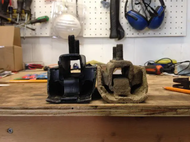

Although the truck is now gone, I fixed the issue! It was the hugely worn transmission mount.
