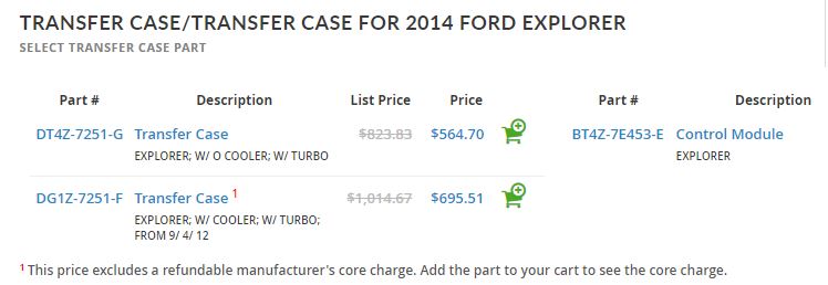

U Ptu Unit Have Cooling?
I thought the Sports have the same cooling the PIU does for the PTU
I might be off base. I'm away for work so I can't go look underneath and see for sure.
I do happen to have the VIN with me so I plugged it into a Ford parts website and came up with the two selections for a PTU. It gives two choices for a PTU, one with a cooler and one without. It says the one with a cooler does not fit my vehicle.
this is a good data I thought that all sports had cooling in the ptu
I also thought all Sports had PTU cooling. An article written for SAE by Ford stated as such. Our Sport has PTU cooling (at least it has cooling lines on the outside of the PTU)... That is very interesting.
