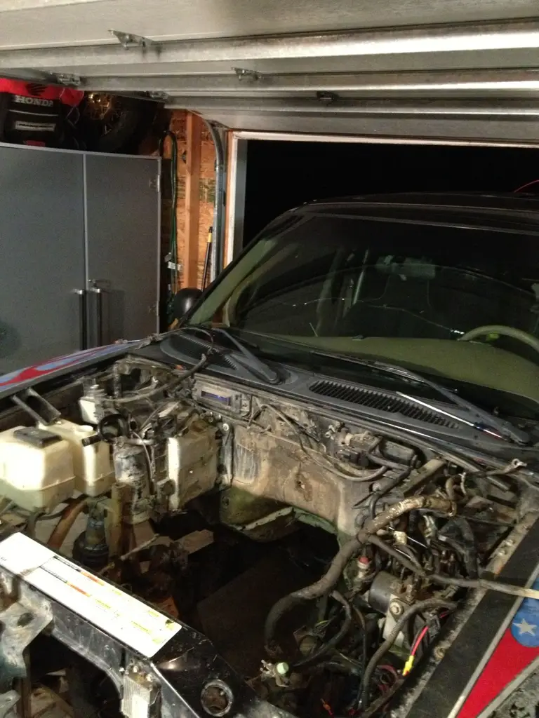

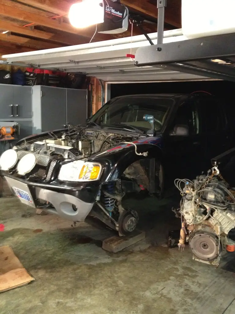

Motor and trans are out of the Trac.
Going to clean up the engine bay, remove the abs, heater/AC box and probably move the battery to the bed to make more room for bump travel.

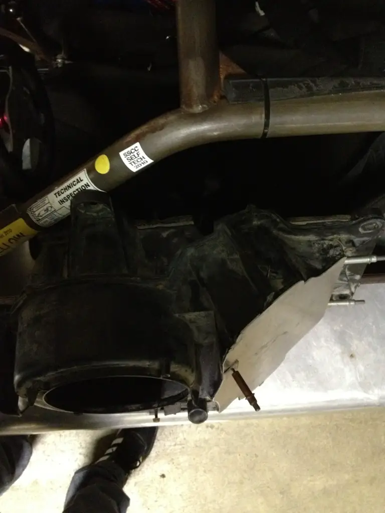

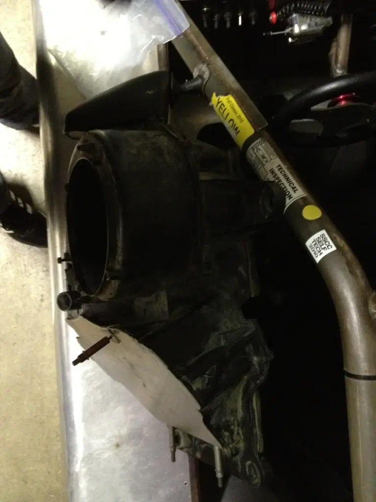

Played with the Heater/AC box to try and get a little more room in the engine compartment.

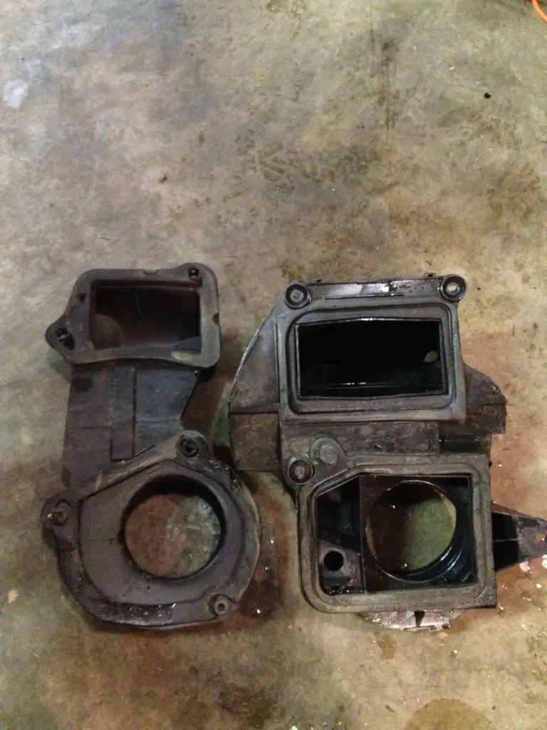

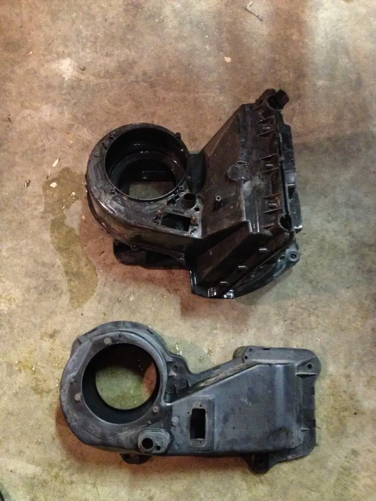

The Ranger Heater only box does not work I found out......Ranger box is the lower profile, but longer one on the left and bottom in the pictures below.
So, we modified the sport trac heater/AC box to delete the AC portion. Cut out the portion where the AC radiator (evaporator?) goes and blocked off/sealed with silicone and a sheet of aluminum.

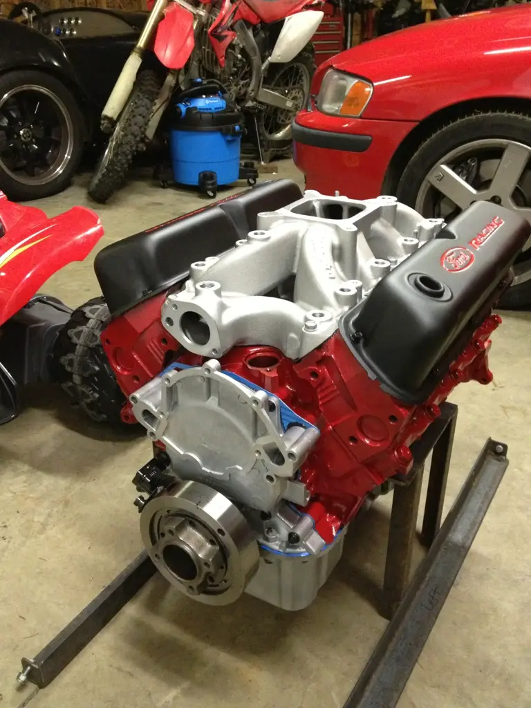

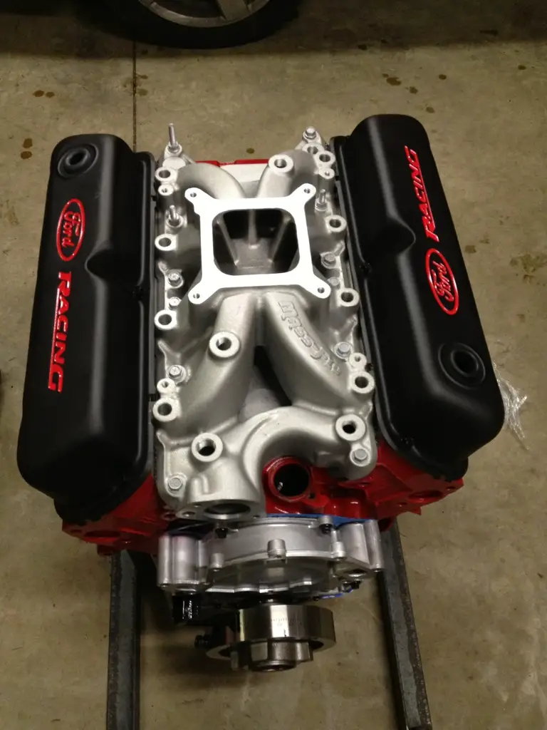

Got the 347 back from the machine shop.
That's engine looks cherry. Thanks for the heads up on the Ranger heater box not working, I was gonna snag one out of a junkyard truck in the spring to do the same thing. I already removed everything else for the A/C, haven't had time to do the heater box yet. What year box did you try?
That engine looks cherry. Thanks for the heads up on the Ranger heater box not working, I was gonna rip one out of a junkyard truck in the spring to do the same thing. I already removed everything else for the A/C, haven't had time to do the heater box yet. What year box did you try?

I went to the yard and pulled one out of a 94' Ranger. Before I got it off the firewall, I had high hopes because it looked like it would work, but once I got it off and matched it up to the sport trac box, it is totally different.
So, I have a 94' non-AC heater box available for somebody that needs one for a ranger v8 swap or a 91-94 explorer........
Ok, not sure what happen to my last post. Lol. I wonder if a Ranger box from a newer one would work? Gonna have to search the web for part#'s and pictures.
I wondered the same thing, although there can't be very many, if any later model rangers without AC? Pretty sure there are no late model expo's that would have a non-ac box.
In my case, it took less time to modify the box I had then to research and track down another box. Would be interesting to see though if there is a Non-AC box available that would work.

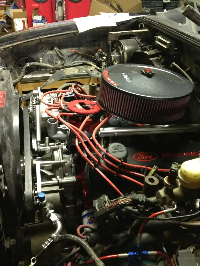

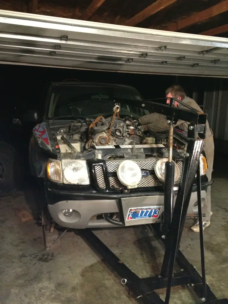

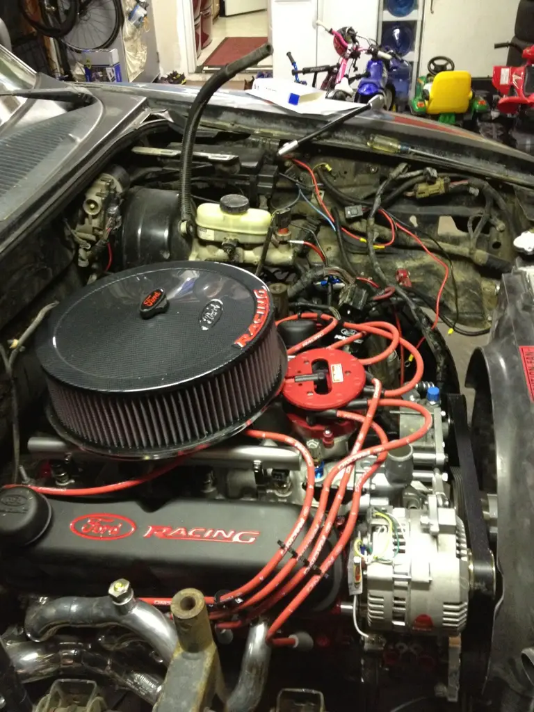

Anyway, here are a few pictures of the engine install. Still a lot of little things to button up, but all the big parts are there.

Glad to see it's almost finished. Can't wait to see pictures of the rig and engine compartment to see how you cleaned all the unneeded things out.
