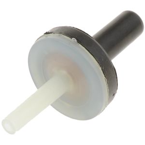

Mine is still hissing. I've replaced the check valve and it didn't fix the noise. The tank seems to be fine, no cracks. Not sure what else to try.

i had the same problem, dealer replaced the HVAC controller (not official name, i will have to look at the paperwork to get the name) but i believe it was a "vacuum manifold" no more noise.
I read this thread after been annoyed for months by this Hissing noise at 2000rpm when in Drive only. I stripped the Vacuum check valve sucked and blew it on both directions and it started to work again. Replaced it and we are good. No more hissing. You guys rock. I guess the valve seat had got stuck.

You can easily check the operation of the "check valve"
Just pull it out (remember which colour goes in which direction" and then suck and blow the valve in both directions. It is a uni directional valve so it should only go one way. Mine had got stuck and after blowing and sucking the valve to investigate it worked again. However this only temporary removed the hissing. I replaced the valve and its better but I still here it at 2000rpm. Not sure what the "permanent" fix is

My daughters 2009 Explorer XLT had the exact same hissing sound from behind the glove box, as described in all these posts. She also had little if any warm air blowing out of the footwell area on her driver side.
Vacuum check of the reservoir (vacuum accumulator) proved it had NO leaks!
Vacuum check of hose coming from engine to the vacuum accumulator proved it also had NO leaks. Regardless of these FACTS, the hissing was there on acceleration and just after engine shut down.
When I read the "check valve" post in the thread, I decided to check it and lo and behold, the check valve was bad! Here is the good part! My daughter is a heart cath nurse and just happened to have some a IV manifold tubing laying around her house. I noticed there was a check valve in the IV manifold, sooo....I removed it and installed it in place of the OEM FORD check valve (7B016 black & white). PRESTO...problem solved! Hissing gone and the floor heat door to the drivers side now opens all the way with good airflow. I will order the proper check valve from Ford and swap it out later.
So if there were no leaks, where was the hissing coming from?
My only explanation is this. The engine provides the vacuum source (when running) and the reservoir/vacuum accumulator stores it! As you accelerate and de-accelerate, this vacuum rate changes. When you shut the engine off, the vacuum supply is gone and the item that locks the vacuum into this system is THE CHECK VALVE. If the check valve is bad, vacuum pressure flows back and forth from the reservoir/vacuum accumulator AND THAT IS WHAT YOU HEAR AS A HISS. NO LEAK, just FLOW! When the check valve works properly, it locks the vacuum in the system and prevents any air flow back to the engine manifold! With the vacuum locked in the system, it also holds that air flow door to the drivers feet in the wide open position. With a bad check valve, that door will not stay wide open all the time, only when running a high rpm~

I had a hissing noise which seemed to come from around the glove compartment, and searched all the above described places. I found the hose that runs around to the front of the engine on the passenger side disconnected and thought I had solved my problem. No, it came back after seeming to be "fixed" after about a week. When again checking the check valve, it didn't seem like there was enough vacuum coming through that line - even though it was small. I followed it around to where it comes out of the plastic box (V-6) near the master cylinder. It went into an "L" shaped rubber receptacle which plugged into the "box" on one end with this line and two others on the other end. I finally got the rubber device out of the "box" and found a small flaw in the inside of the "L" and it acted like a flap over the hole going to the line I had been following. I took all three lines out, ran a drill bit (no drill - just the bit) through all the holes and reinserted all three lines completely through the holes and into the larger area at the top of the "L" and reinserted it into the "box". Going back to the check valve, I noticed a greater vacuum. I have not heard the noise since (about 10 months). This problem would probably have resulted in an "unable to duplicate" notation from the dealer, but persistence worked for me. Hope it will help someone else here.

I had been hearing a hissing noise any time I accelerated. I discovered the sound was coming from the vacuum reservoir tank located under the glove box. Is anyone familiar with this issue? Will replacing the reservoir fix the issue? I made sure the T connector with the hose was secured properly. I'm not even sure what the vacuum reservoir tank does if anyone can clarify.
I was hearing the same noise in my 2008 Explorer when accelerating. In the engine compartment, in front of the passenger seat there is a check valve in the vacuum line running through the firewall. Air should only move one way through the valve. Mine allowed air to move both ways. Bought a new one at AutoZone for under $6 with tax. I installed it and, bam! No more hissing during acceleration.
