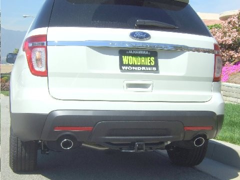

Look at the Hidden Hitch option. There are pics of a white Ex with the hitch installed in the 'Reviews' section. Looks good. I'm getting ready to order so I can rack 2 bikes.

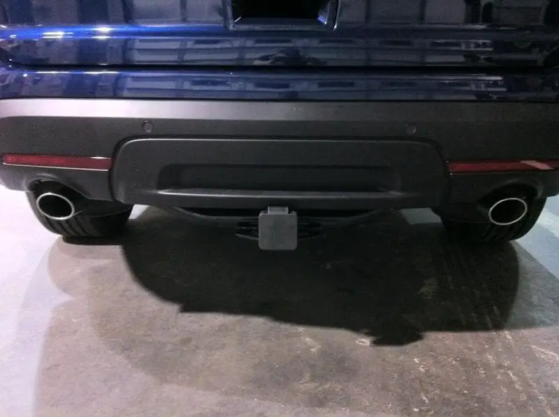

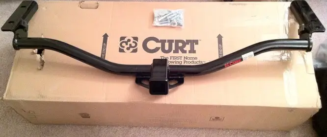

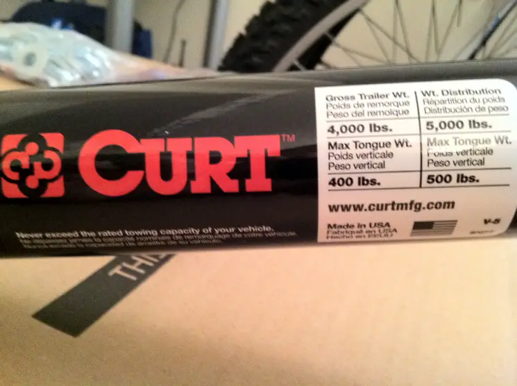

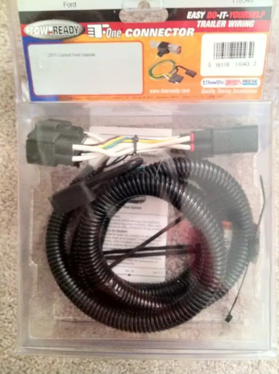

Installed a new Curt hitch. took about 45 minutes total. No cutting or welding and it was a perfect fit. Instructions were spot on.
$135.00 total including the wire harness, reciever cap and shipping. Got it through Amazon.com brand new.

Thanks for the pictures. I am thinking of getting an aftermarket hitch, since I have an Eco-boost unit and just need to tow my small utility trailer and Segway. Any real negatives with U-Haul?

That looks good,thanks for posting the pictures. I'm getting Curt hitch also.
