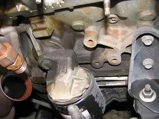

Found the source of an old oil leak
I was just under my truck replacing the rear differential oil when I thought I would check out an old engine oil leak again I've had. I've randomly replaced seals but the leak never stopped, I assumed it was my rear main seal leaking. 2000StreetRod (Dale) suggested I check the oil filter mount to engine seal. Upon initial inspection it looked dry, but upon further scrutiny I found oil above the upper pan and on the block itself, higher than the pan gasket or rear main seal, ruling out those seals as culprits. I took off the exhaust manifold for continued inspection and sure enough, the filter mount is the culprit.
I removed the header to remove the oil filter mount to replace the seal on the engine block side. The seal had shrunk and became brittle due to the engine heat. I replaced the seal.
I am thrilled now as I believe I have fixed my long sought after oil leak. I had been loosing about half a quart ever 10k miles. My SOHC should now be oil leak free once and for all! Sometime soon I'm going to buy a brush on a wand that I can use to scrub off all the old oil cud off the block and pan.

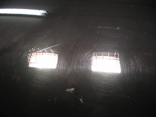

I spent some quality time with the explorer this week. I spent about ten hours with Meguire's Ultimate compound, clay bar kit and an Autozone cheap orbital buffer and Meguire's NXT 2.0 synthetic wax. First I washed the truck with dish detergent to remove any old wax left on the body and got to work. Here are the results:
before (looks like sand paper)
after
There are now zero swirl marks and all light scratches have virtually disappeared! An almost mirror like finish!
