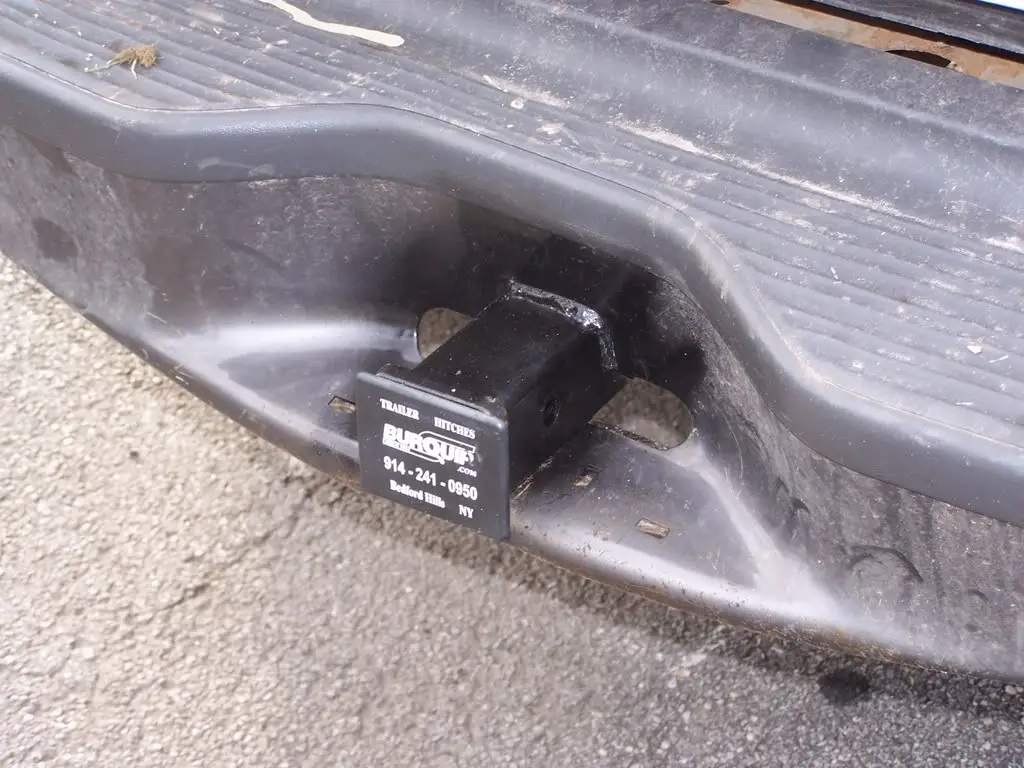

So I went to the local truck equipment hitch place and got one of these fabrication hitch pieces
http://www.drawtite-hitches.com/images/design_images/2850.gif
http://www.drawtite-hitches.com/fabrication.htm
It cost me about 20 bucks and was 1 foot long.
With my 33s I had no use for my factory spare tire. so that got chucked
and I fabbed up a way to mount the 2inch hitch

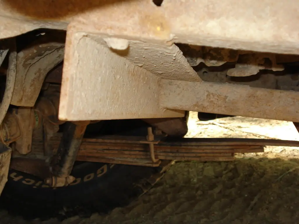

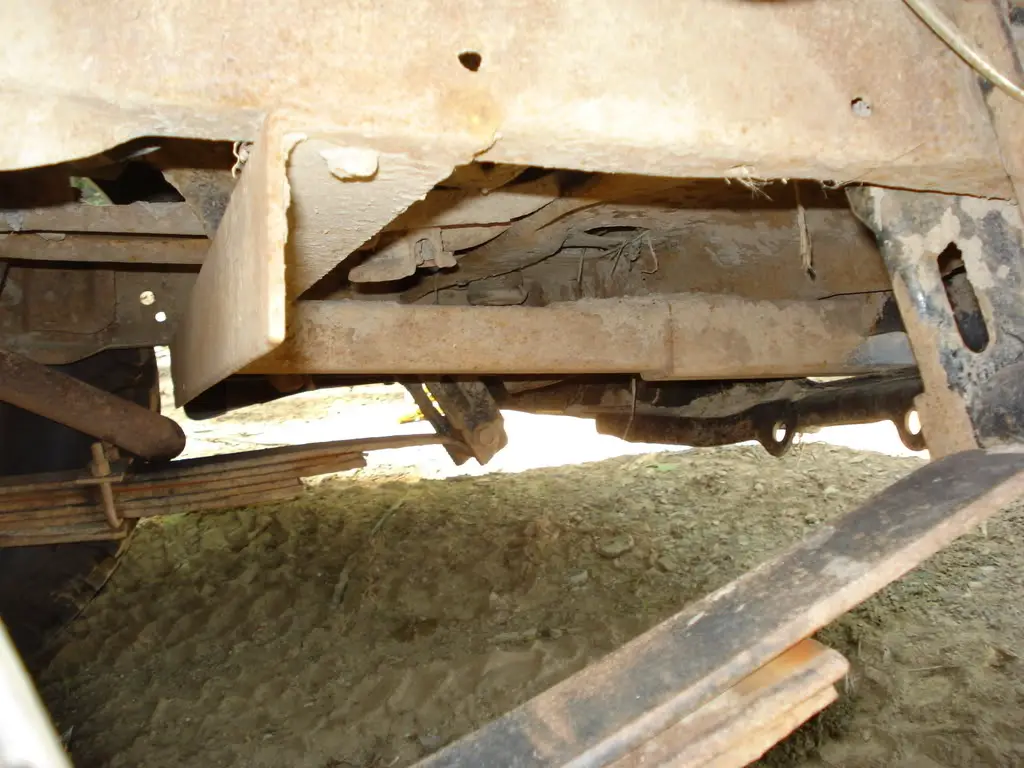

I trimmed the bumper step plate so the hitch would fit tight then tack welded it.
I mounted a angle iron across both frame rails and extended the hitch piece enough to brace it up.
Alittle spraypaint and a cover and here is what you see

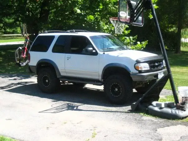

And here it is in use.
check out how much clearance I have under the bike rack
plenty for back country excursions or shuttle runs in the good old explorer
