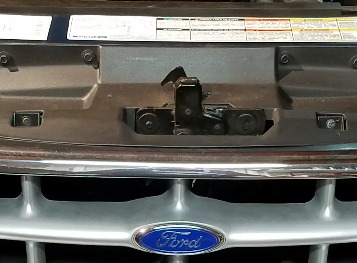

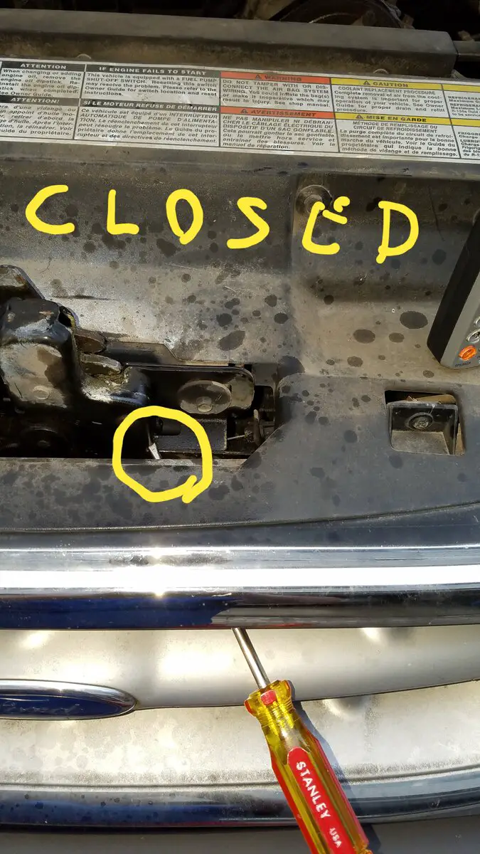

I had these pics on my phone from when I had to open mine five or so years ago. I lowered the rubber on threaded-rod bump stops a tad to prevent it from being too tightly closed.
I've kept it clean ever since!
