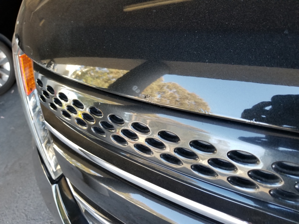

I'm brand new to this forum so bare with me. I'm not very well versed in the forum world. I need advice on what to do with my Explorer. I have paint bubbles all along the edge of my hood from the corrosion of aluminum. My dealership won't touch it because its over 35,000 miles. Which is ridiculous, but that's a whole other subject. I've been detailing my cars since I could drive. I have a big selection of detailing products and tools. For some reason detailing relaxes me like nothing else. But watching that beautiful Tuxedo Black paint chipping off my hood is like torture to me. Because of this, I'm planning on taking my skills to the next level, serious paint correction. I definitely don't want to shovel out over $500 to fix a problem that could possibly come back again. I'll attach some photos of my vehicle and tell me what you guys think. Am I crazy? Has anyone effectively solved the rust bubble issue on their Explorer?

Yeah i forgot to mention that the area under the passenger side headlight was painted by the previous owner. Wherever he went to get the work done was not a very quality shop. The paint has slowly been chipping off from debris. I'll need to fix that as well.
Clean car, I don't think you are crazy. I'd want it fixed too if it was my car.

Unfortunately, the only way I solved it was by buying a hood deflector. Luckily since yours is black (like mine), it won't be as noticeable. I thought it looked hideous at first, but its grown on me. It definitely looks better than corroded aluminum, which paint correction will not fix.
