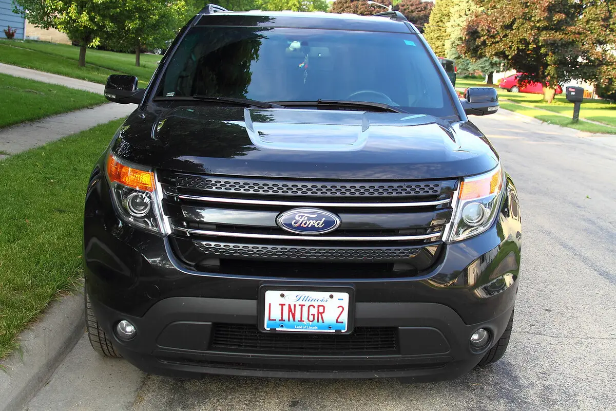

here are my photos, after 39 months of ownership, 50,000 miles.
I wash the explorer regularly and I wax it at least 2-3 times a year.
This is shit design/quality, there must be some galvanic corrosion going on with that aluminum hood.
