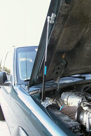

I see Rick tried these back in '00:
His thread is here.
EXPLORER EXPRESS
I've summoned Rick for his opinion(s). Anyone else used them? I wonder if EE even carries them still given that most of the items they list on their site aren't truly available any more. :rolleyes:
I loved the struts. Worked very well. Unfortunately I never adapted them to my fiberglass hood.
I have never seen struts give out suddenly. They lose their tension over time and it's easy to tell when they need replacing.
For example, the factory struts that are on the trunk of our Mustang are in need of replacement. They lift VERY slowly and won't hold the trunk as wide open as they used to.
