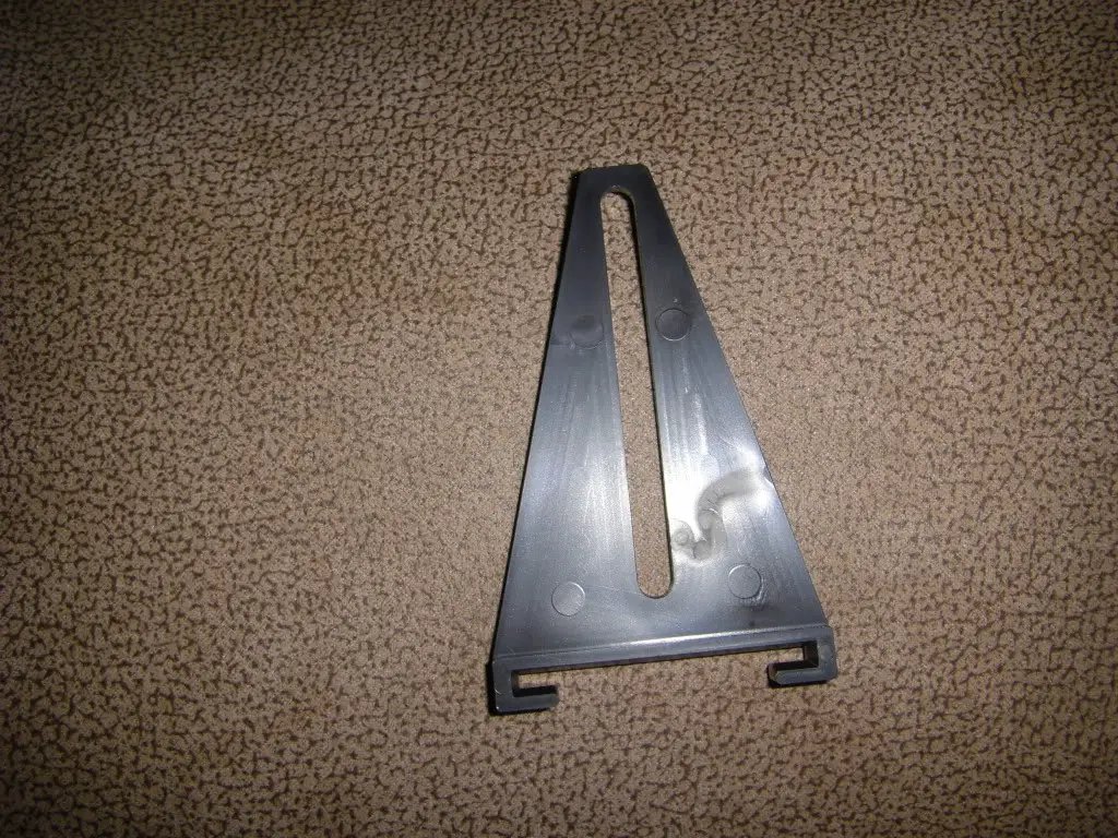

I was wondering do you have to actually trim the dash? I also bought the metra dash kit
that came with a triangle rear brace thing
I don't have the deck in yet, but was wondering if anyone had to brace up the back of the deck? thanks

I braced up the back of my unit using the triangle. You may need to pick up the correct size screw to attach it to the unit as most do not include the screw. The same goes for the side plate screws.

yes, definately use the triangle brace, it will stop the deck from bouncing, doing it will help in the longevity (life) of the deck.

well I guess my kit was wider than most because I had to shave a little off each side as well, but oh well it fits just fine now. Also the screw hole for the brace was too high for the triangle brace to go in (it wouldn't even make it to the bottom) so I attached it to the bottom of the deck and then put some double sided tape on it just to secure it better. Pics to come soon.

Looking at this thread again before I do my install, noticed today thoug, I got the metra kit, but no triangle, I do have a schoshe triangle from my old pos dual from my ranger, but it wont mount because my unit has a heat sink in the middle of the back. Any suggestions? Also, looking at the metra instructions, I don't quite understand what, if anything, keeps the unit from sliding fore and aft. Are you supposed to attach the trim ring from the front, unit and side parts from the rear of the bezel?
The triangle is supposed to keep it up and i think put friction to prevent sliding. I screwed mine underneath to obtain the right height and slapped that puppy in.
