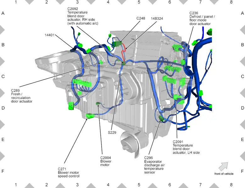

C2092 is the actuator you need to replace.. there are 4 so my guess is you replaced the wrong one.
The link doesn't work
Link works for me.

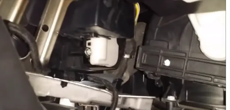

Where is that one located? I did the one on the passenger side basically against the center hump where you remove most the dash.
I replaced this one. It's the YH-1779 motor.
The bottom right shows the arrow for the front of the vehicle. It looks like middle to left on drivers side at the top.
If you changed the one on the passenger side, you either replaced the drivers side blend door or the defrost/floor mode blend door on the top right.
This is the one I replaced. I need to get this fixed before my wife gets even more frustrated with me than she already is.

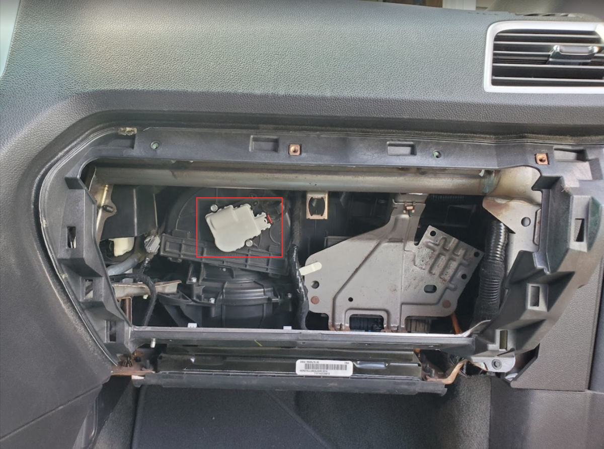

Sorry to renew this post, my post got merged with this one according to what I saw. Anyway... I just purchased a new blend air module behind the glove compartment hoping that would fix the problem - but it did not :( When I remove the module (but leave it plugged - I can see the gears turning (on the old one as well as the new one).
At this point I turned the passenger side to LO and still raging hot air coming out. Even though the gear had to be turning once in place. So - what is the next problem I need to fix?? It looks like there is another one to the left of the one I have highlighted - is that my next plan of attack?
Thanks in advance! Andy
I've been trying to get to the one on the side for about an hour. That thing is impossible to get at. I can't get to the screw in the back and even if I did - I'm not sure how the heck I would be able to get at the wiring :( I feel like I need to cut out that plastic box that is in the way, but I hate do do something that will cause me more problems in the end.

Hi Andy,
The actuator that is right behind the glovebox controls the fresh/recirc air intake only.
The one to the left of it, and perpendicular to it, controls the hot/cold blend for passenger side.
As you have found out, there's two screws holding them in. As I recall, they are 8mm, may even 7mm. The one that's tough to get to, toward the engine bay is easiest dealt with with a tiny wrench.
It's a pig of a job though.
S
Yeah - I finally just cut through the plastic holding the wires, got the thing installed with just 1 screw (tight) and it is all working. My glove box broke on the right side, so I'm going to have to replace that now. But I can also just keep it closed. At least I have AC/heat on both sides now!!! I can only imagine the cost if I had Ford do that.
