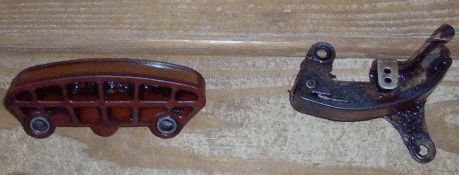

I just finished the front timing chains, plugs, and wires on my 2002 Explorer last night. I had the famous rattle from about 2,200 to 2,800 RPM and it started in January at about 128,000 miles. I fully expected to see the main chain flopping around and bits of plastic in the oil pan and pickup. To my surprise, when I pulled the front cover, everything looked good and there was no slack in any of the chains. I then pulled the oil pan and it was clean. I replaced the main chain, sprockets, left cassette, and the left & right tensioners but it made me unsure if this was my problem or not. It turns out it was! No rattles at all this morning driving to work! The springs must have been wearing out but not yet broken.
How many of you have experienced the rattle and found a “visually intact” tensioner?

The 2002 models are supposed to have the upgraded primary tensioners. Was yours a 3 leaf or 6 leaf tensioner? My 3 leaf was broken but did not appear to be but upon further examination I found it was not exerting any tension on the chain.
I had the older 3-leaf tensioner and mine is a late build truck. The date on the engine is 4/13/2002. Perhaps they were trying to use up all of the inferior parts first.
appearance deceiving
My primary tensioner appeared to be intact but all 3 leaves were broken near the pivot.
