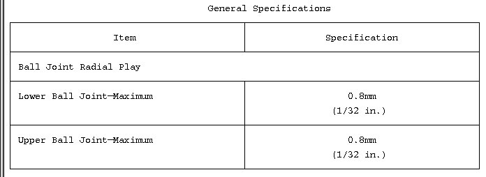

The mechanic said that I need new ball joints on my 98 Explorer 2wd. The boots are cracked but I have not noticed sny problems while driving. The dealership wants $1032.00 to install new ball joints and do an alignment is this a fair price?
The specs say that you should have less than 1/32" (0.8 mm) play in the ball joint. So if you lift the front wheel(s) off the ground and try to move the top and bottom of the wheel in and out of the wheelwell, you should not get more than 1/32" movement. 1/32" is not much at all, so if you feel any movement, it is probably time to replace the ball joints.
