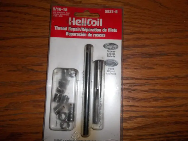

The Egr elbow is aluminum so it is very easy to cross thread those bolts. I suspect that is what happened.
You might get away with stacking up some washers to get it snug, but if this doesn't hold you will probably need to remove the EGR elbow and install a helicoil
In fact, this happened to me. Here is the kit to use for a 5 /16 - 18 x 3/4" bolt
