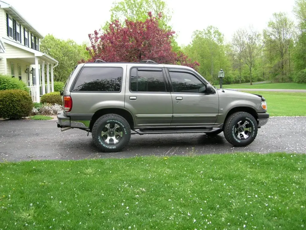

TT in front and Monroe coil overs in back..31's.
ATTACH]
