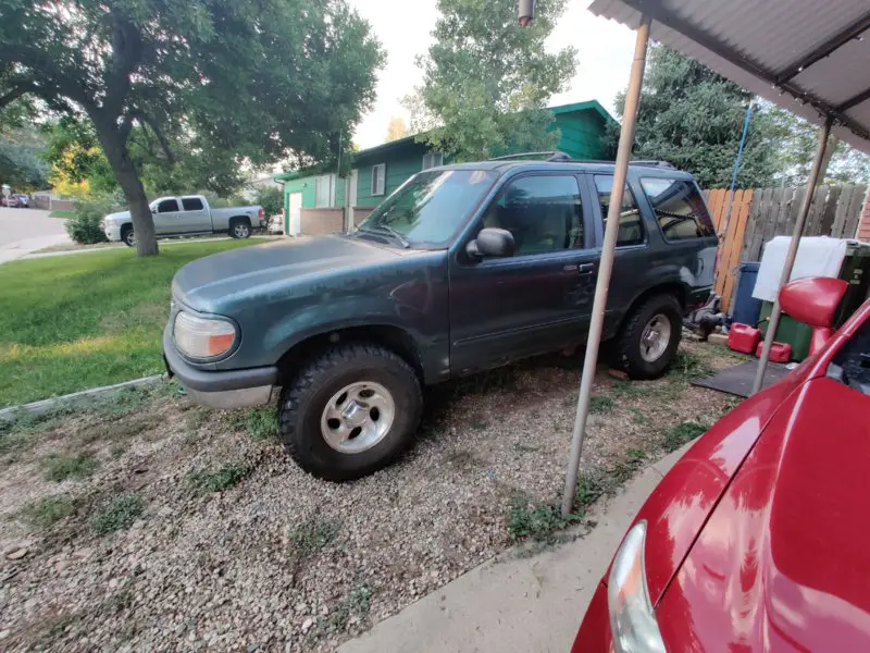

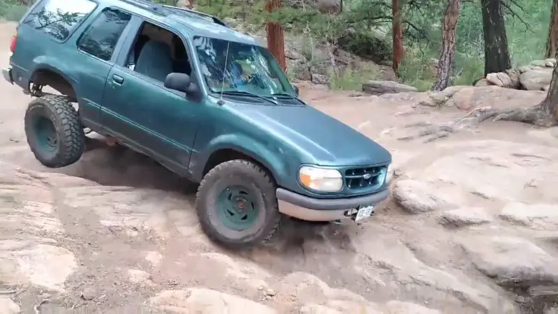

Here is my lift with only about 2" of lift with 32's on her.
This was taken on China Wall
I also live in Colorado.
Chinaman's Gulch by Buena Vista? Very popular spot. The group had a few breakdowns last time, the consensus was that rains had made the rocks more prominent. Then again the leader always took the hardest line. He was rebuilding his torn up under carriage last I heard.
I'm looking for an economical way to lift 2". Just want bigger tires for more ground clearance. Any economical ideas on that? I wouldn't do it but I have the tires mounted on wheels already. Seems like a waste.

No Not Chinamens Gulch China Wall in Terryall County.

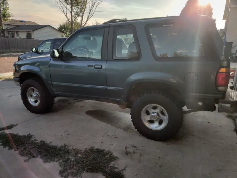

All I did was Twist my Torsion bars all the way up and did a 4door leaf pack and a Add a leaf. Here is what she looks like after the 4 door leaf pack and the add a leaf on 32's. I am happy with her so far. Had her on Mini moab in Rainbow falls and now up China Wall In terryall county.

I think what worms did with his is just what you are looking for. Its about as cost effective as you can get.
WormsExplorer
February 14, 2015
1,196
352
Location
Colorado Springs, CO
Colorado Springs, co
97 Sport 4.0 ohv auto
After getting the Add a leaf installed the ride did not really stiffen to much. I still like the ride of my truck. Once adding the add a leaf I have not flexed it yet. Here is what the spring pack looks like.
Mine is the sport so just a 2 door. Normal rear leaf is a mono leaf. So I took a 4 door leaf pack and it raised the rear about 1.5" adding the add a leaf I think she went up another inch or so. So total about 3". Give or take. Totally forgot to measure before and after the add a leaf. Next I want to lift the front a little more to have her a little more level. Will see after adding all the goodies I want in the rear.
