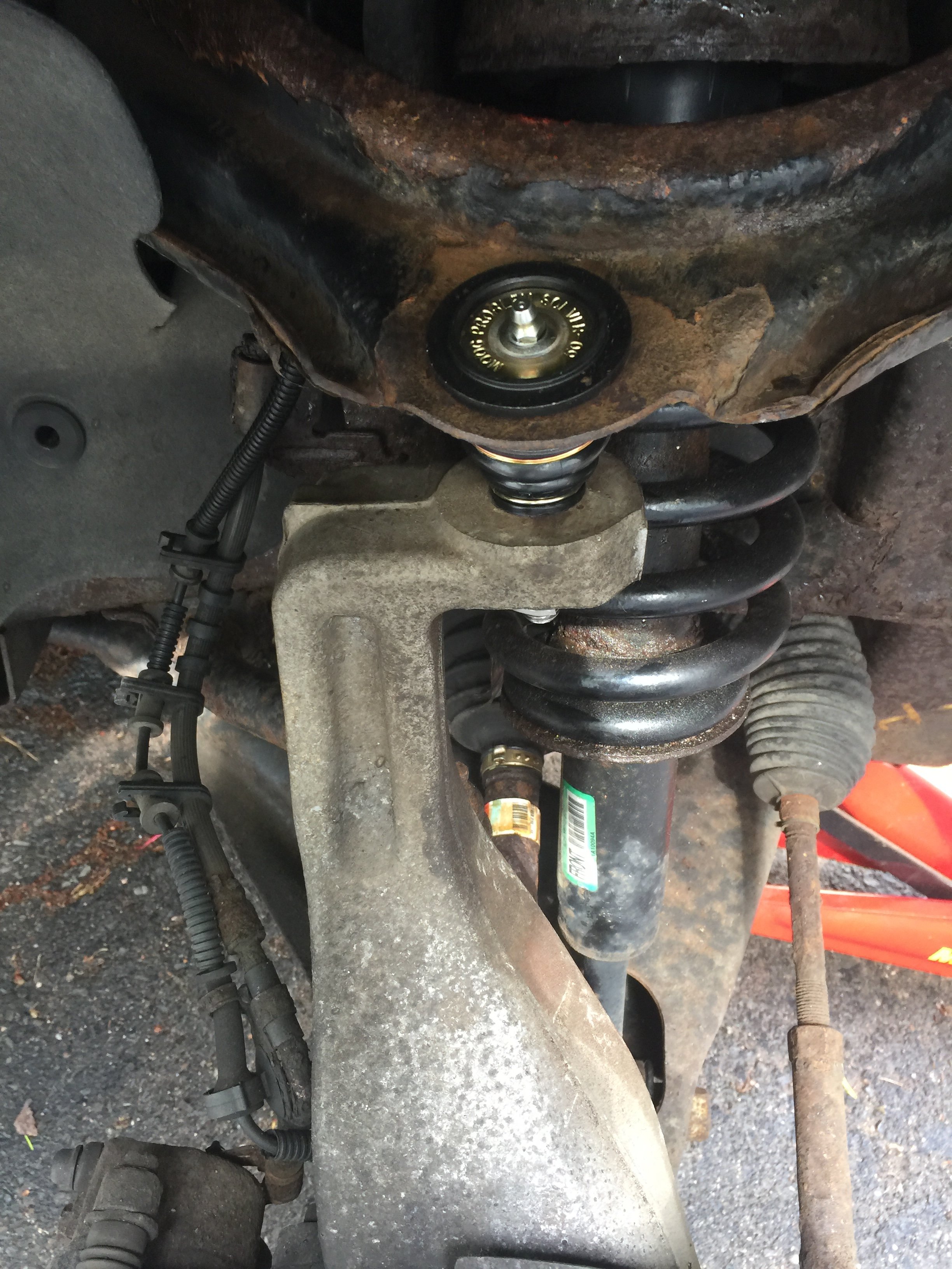

I got the front mount drilled out today, I had to use carbide to get a hole started.
Body Lift is officially complete. All that remains is to re-install the front bumper cover.
Here’s that mount, torqued to 41 ft lbs, with a lock washer and loctite.
Passenger Side #1 Mount
Lock Washer and Loctite. The OEM bolt broke from the top, and was seized into the body mount. I...
