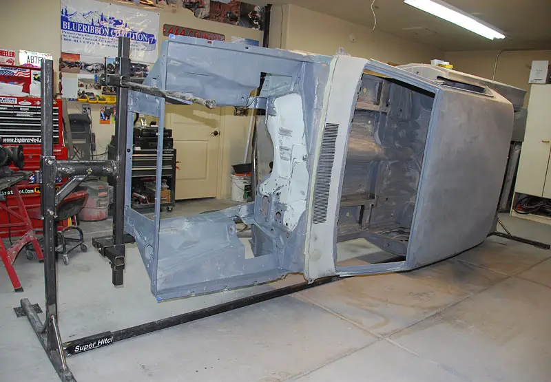

The "axle" bracket that is mounted on the upright in my photo is cinched in place with bolts protruding from the side. Once the proper height is determined, I will drill a hole all the way through the upright, just below the bracket to act as a safety stop.
