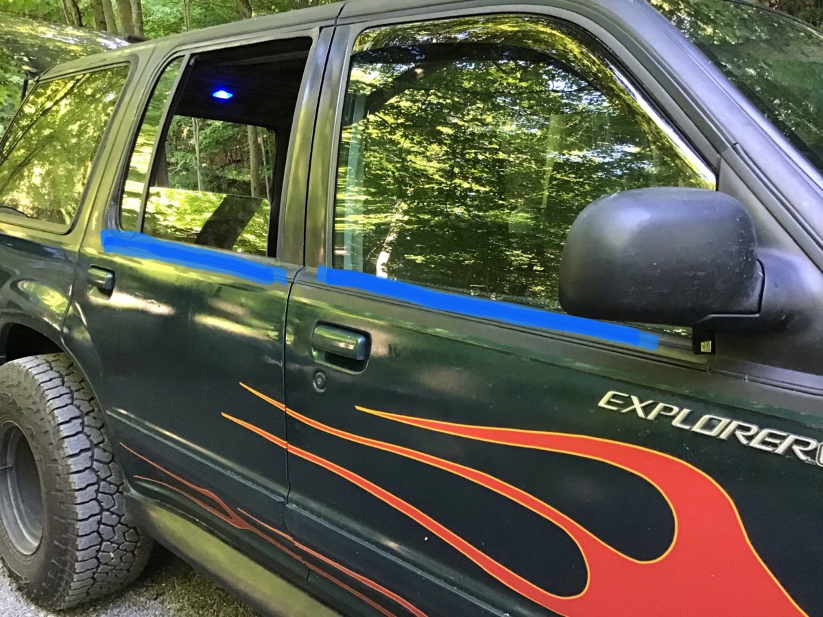

Each front and rear door window has a belt molding shown below, and in the area highlighted in blue.

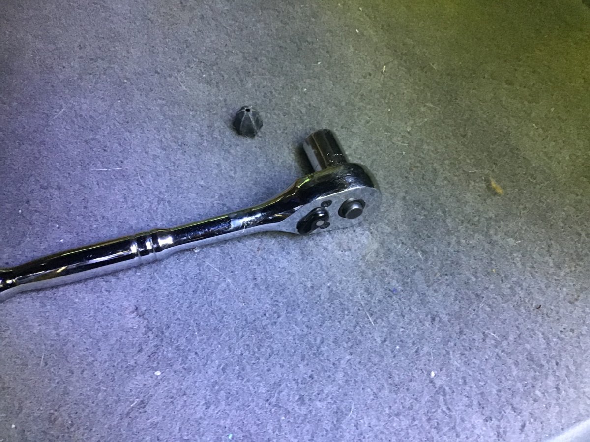

Each belt molding is removed easily, using only a 10 mm socket and a 1/4” driver.

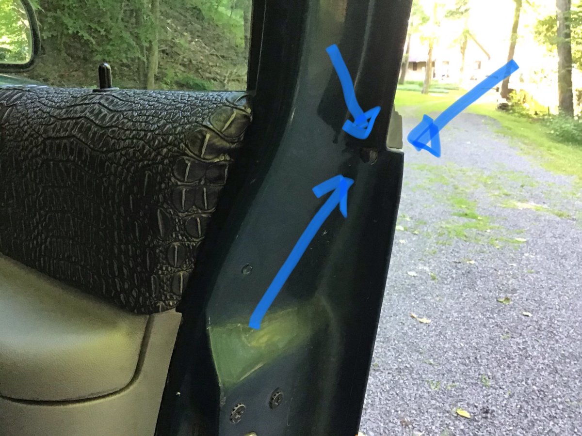

The small nut (one of the nuts is shown above) for each belt molding is located on the backside of each door. The photo below shows the nut for the front door, indicated by blue arrows.

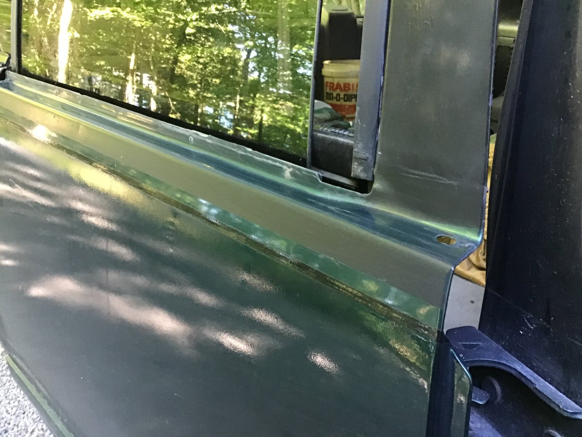

The photo below shows the rear door with the trim removed. The hole for the nut attachment is easily seen.

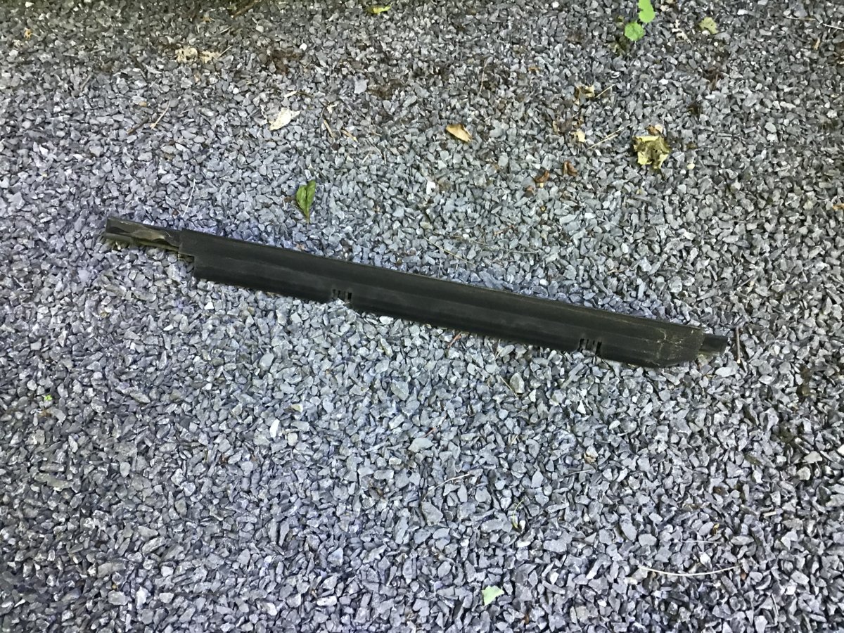

After the single nut for each belt molding is removed, the belt molding/window felt piece can be easily cleaned with a brush and any mild cleaner, then rinsed. The felt pieces are easy to clean, and lots of mud and road grime can be removed. Upon reinstallation, the metal clips on the belt molding slides entirely BEHIND the metal for the door.
Finally, the window felt and belt molding are CLEAN. Just never knew this was so easy and wanted to pass it on.
