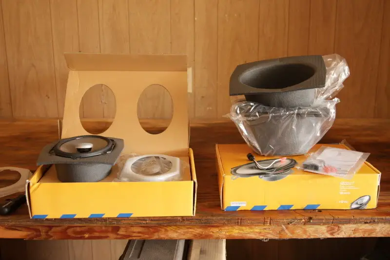

I ended up not using the foam buckets....they were too deep!

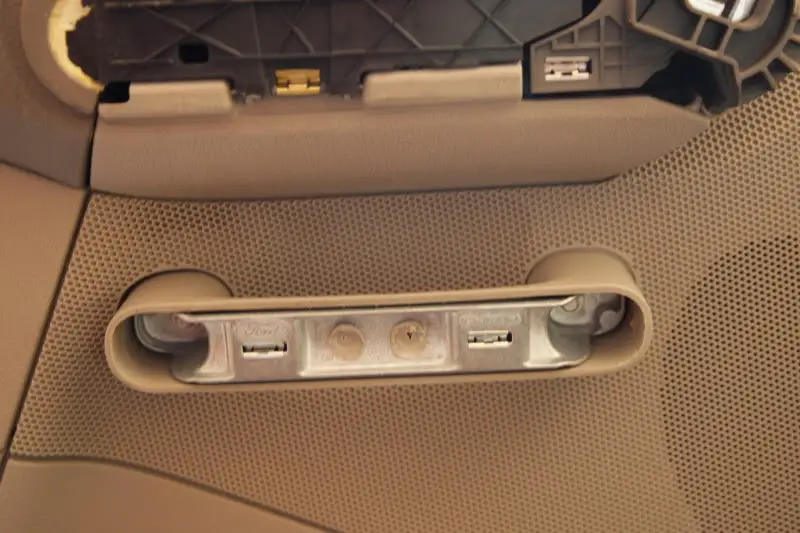

First steps are to pull off the handle cover:
There are (2) 7mm Screws that need to be removed behind it.
Then pull off the window switch cover:

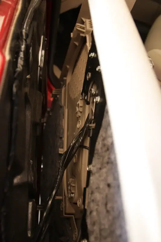

Remove final (2) 7mm Screws at the bottom of the door.
DO NOT PULL DOOR PANEL OUT, you must slide it upward to release it from the door. There are no PUSH PEGS in the connection between the door and the door panel.

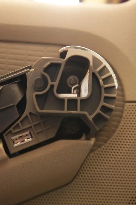

The hardest part is removing the door latch cable. I was not able to get a good shot of this but I found the easiest way was using a pair of needle-nose vice grips that I gradually set the tension on the black clips on either side of the cable retainer until it released from the door panel. Once it is free you can rotate the cable down and remove it from the pivot.

Comparison between stock speakers and infinity 6832’s

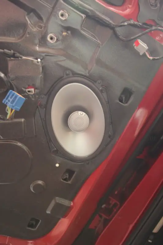

Remove the stock speakers by removing the (4) 6mm Screws
New Speakers installed:
