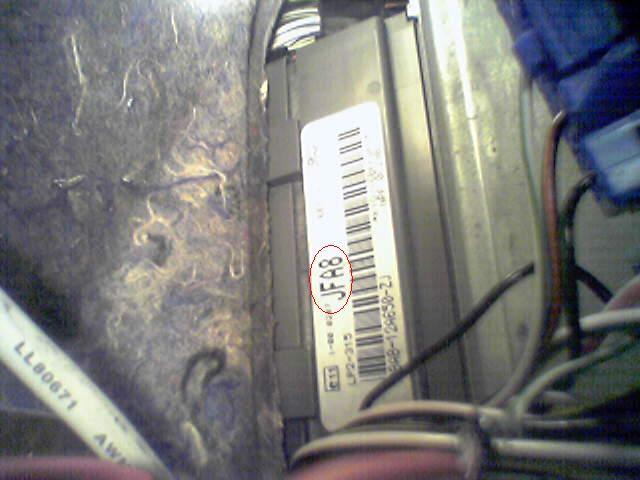

This is basically what I do at work, but more on the GM side (since they are a lot easier). Ford put catchword stickers or "tear tags" on their PCMs and either under the hood or in the door jams of the front doors. They are usually hard to find, but for my 2000 4.0L SOHC it was right on the computer/connector (passenger firewall).

Here's a pic of the tag you need:
So lets use that for an example. So the code is JFA8. What you do is bring up your Excel sheet and type CTRL + F (which is FIND). Type in your code: JFA8
What it'll do is take you to the catchword that goes with your vehicle. These catchwords are model specific.
What you see should be your vehicle. In this case it's a 2000 Ford Focus with a Zetec 2.0L
