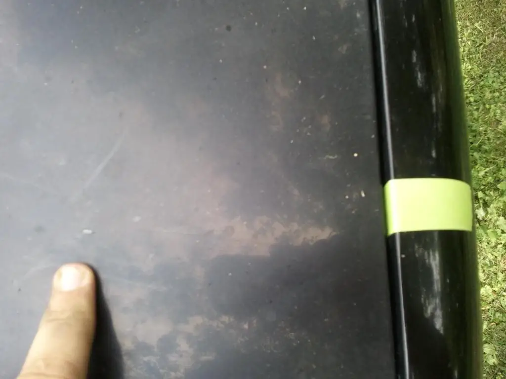

Next it to take tape, masking tape or similar. Take it to the furthest edge of the hole all the way to the outside of the fender.
Tape
Measure from center of hole where your going to put hood pint to the inside of the fender. Write the measurement down so you dont lose it. In a perfect world both sides are the same, in my case they were different so dont mix measurements. MEASURE MEASURE MEASURE; unless you have a spare hood laying around you dont want to screw up!
With hood closed you can measure from inside of fender to place on hood and use chalk to mark the hole. this is what the tape is for to make sure you lined up with the tape.

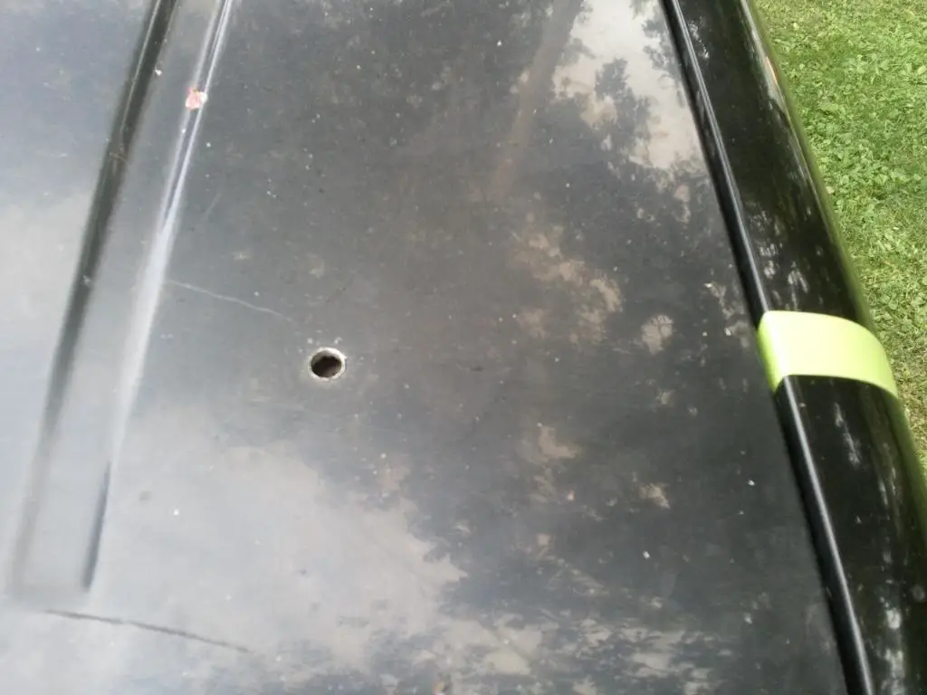

Next is to drill a starter hole on the line. once you have a starter hole. Use your bit that is slightly bigger then the hood pin
This is a good time now that you have both holes drilled, to spray a little paint on the drill marks so you dont get rust. Once your don if you measured right, put the hood down. Adjust the hood pins (by turnin the top nut to the height of the hood pin you want showing above the hood)

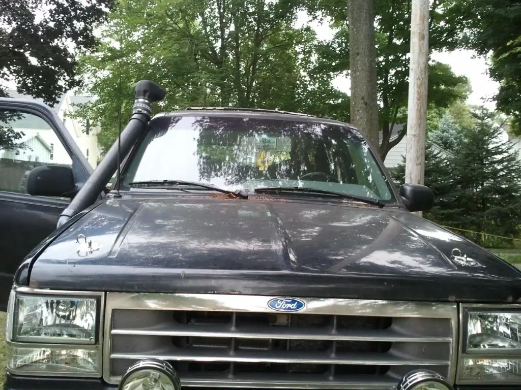

The latch on mine wasn't holding because a metal piece in the hood broke.
the hood bounced up and down with only the second safety latch keeping it from flying up into the windshield. Couldn't get the factory latch working right, so I decided on hood pins.

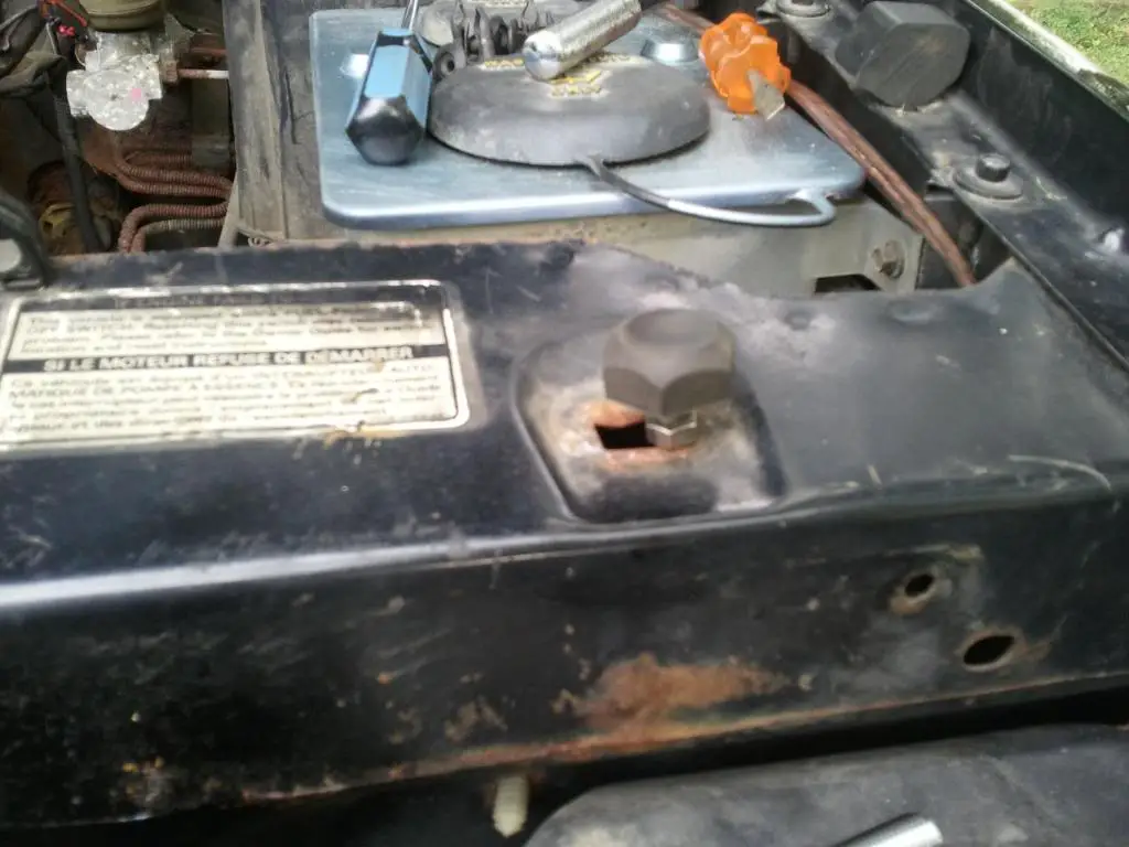

I left the old latch in place, the old bump stops too,
and found flat spots near the hood bumpers on the bracket to drill & mount the pins.
With the pins mounted, closing the hood on them (with a little force :hammer:)
marked the right spots to drill the inner, then the outer sheet metal of the hood
Works well, but the disks are rusting already.
