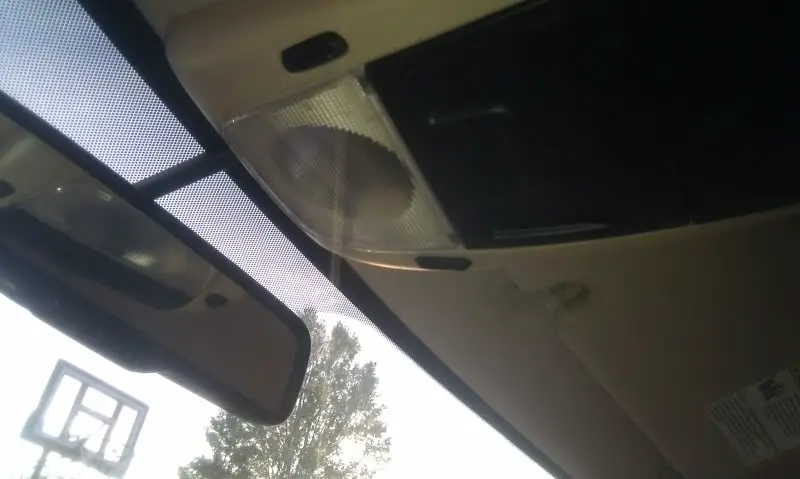

first thing is to remove screw from over head console.
once you take remove screw, you will need to pop down front over head console, carefully.

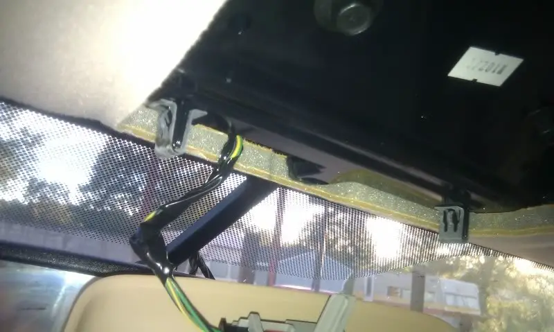

just wanted to show everyone what holds the front part of over head console. Then you unplug connector to the lights.

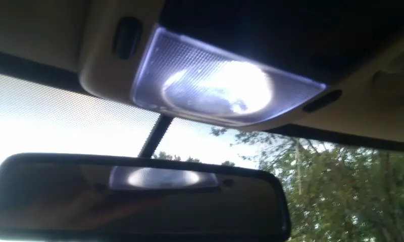

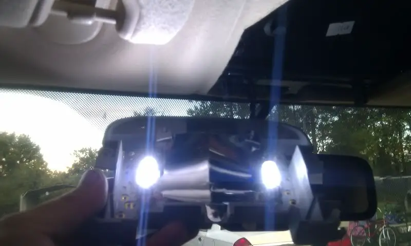

picture shows the LED bulb installed. You may need to adjust (by turn them) them once you install the overhead console, at least temporary .
I plugged them up to test them out. I belive they are bright. (turn on the LED bulbs, to see if they work. If one of them don't work, you may need to flip the bulb around.)

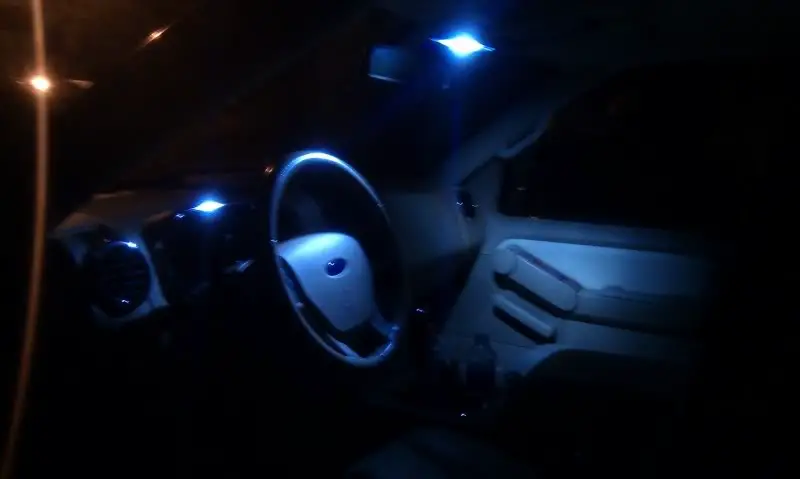

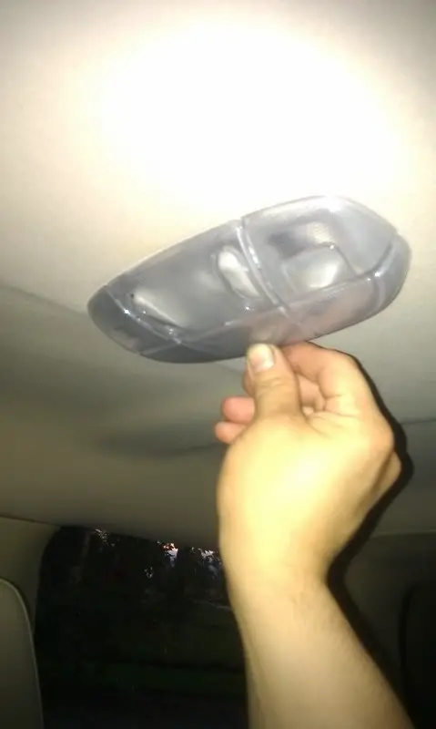

here is a couple of pictures already installed.

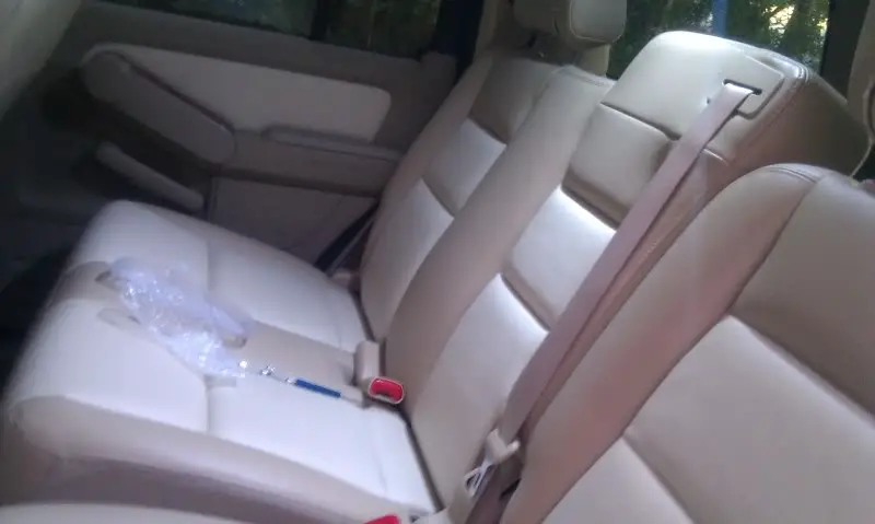

part 2: 2nd row seat light bulbs replacment (from regular bulbs to LED bulbs)
regular bulbs still installed in 2nd row seat lights.

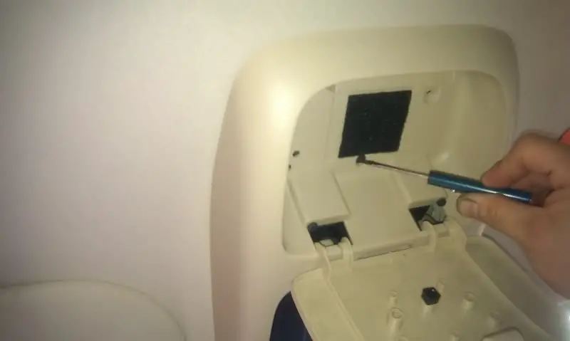

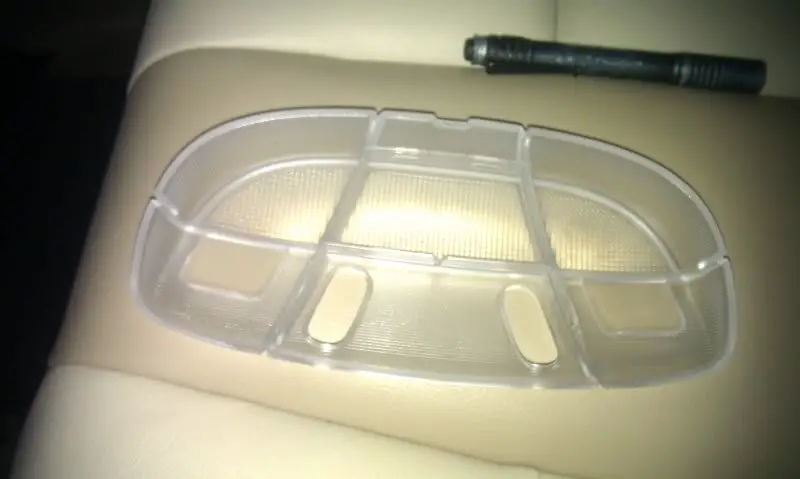

basically what you do is pop cover off, carefully. I used a pocket flat screw driver.

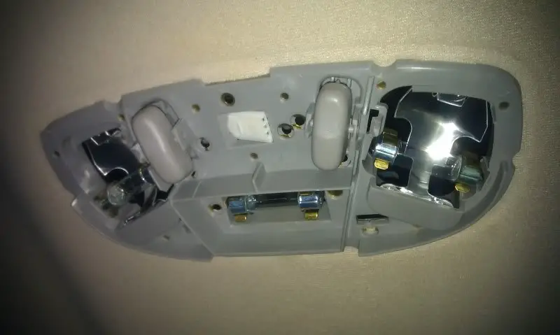

this picture shows the regular bulbs still installed. you need to remove bulbs, carefully. then install the 3 LED bulbs. turn on the LED bulbs, to see if they work. If one of them don't work, you may need to flip the bulb around.

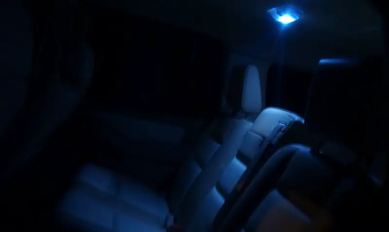

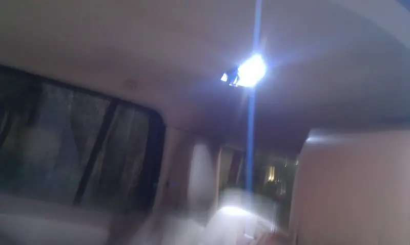

sorry for bad picture, cell phone. it shows the leds on with out cover.
then you reinstall light cover. then test the bulbs

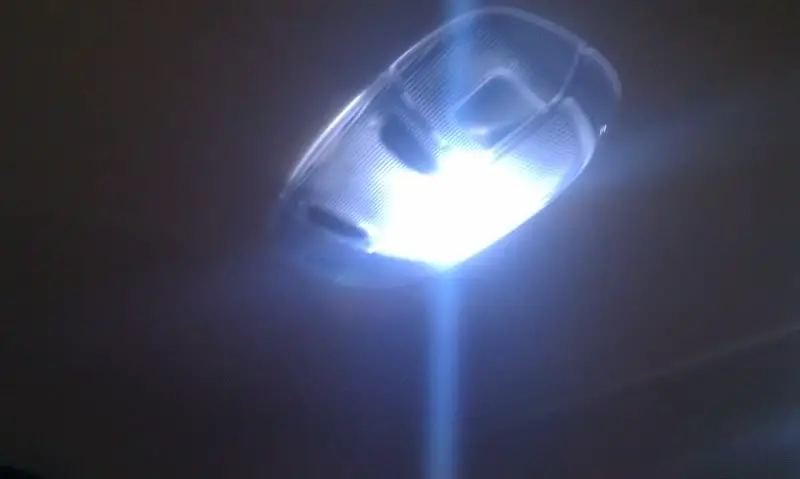

now it cover on.
this picture shows how bright the lights are with cover on.

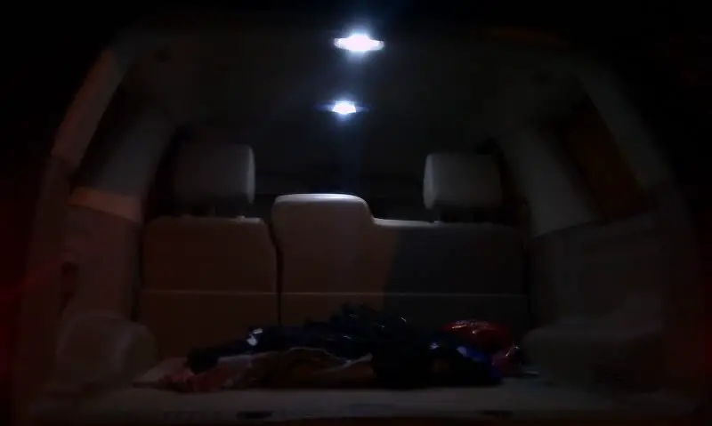

part 3: trunk light.
you basically do the same thing as in part 2.

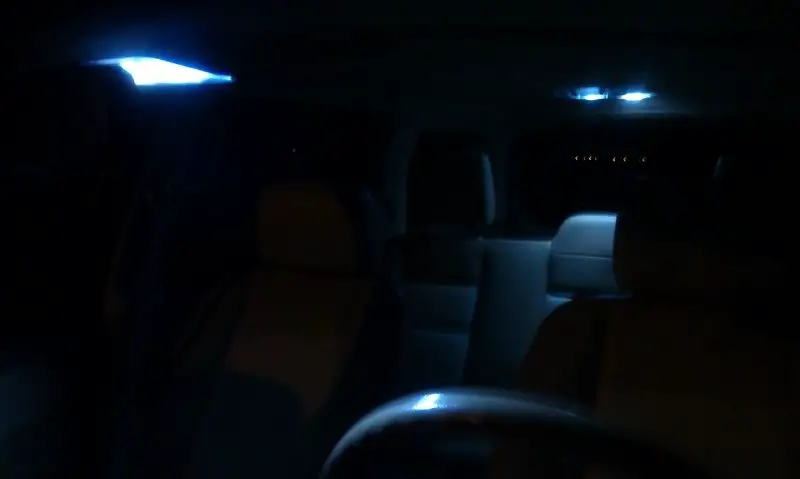

all that hard work is well worth it, lol. here is a couple of pictures of the finish project.
don't mind the mess in the trunk area (work uniforms).
