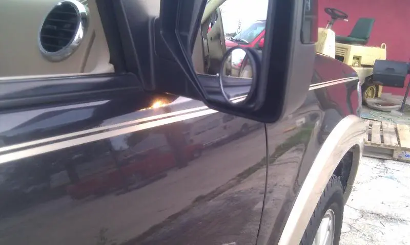

this is for passenger side. you can do the same thing for the driver side.

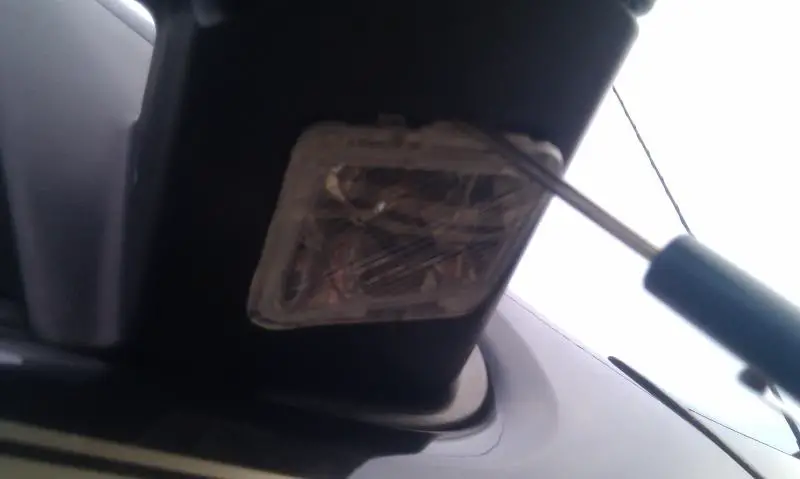

use a pocket flat screw driver to remove light assembly.
turn bulb socket counterclockwise, to get to bulb.

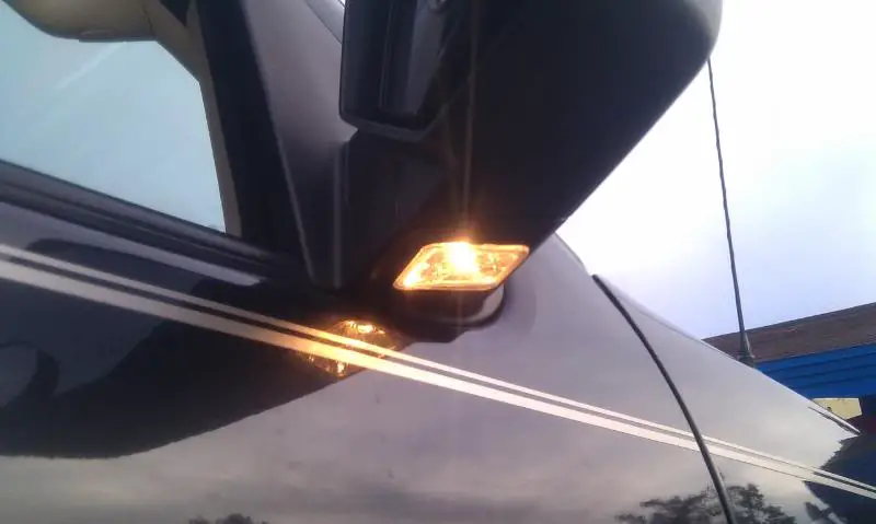

regular bulb vs. LED bulb.

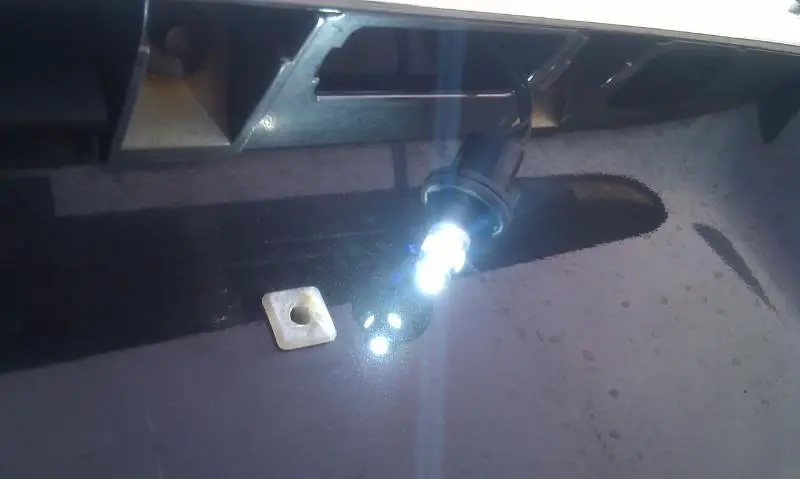

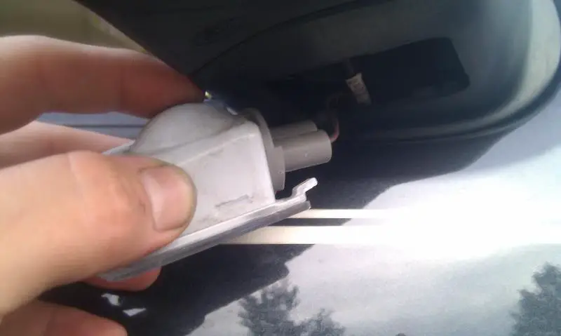

part 2: LICENSE PLATE BULB REPLACEMENT.
regular bulbs still installed.
you need to push on little tab in order to remove bulb assemly.
this is a comparison, regular bulb and LED bulb.
reinstall bulb assembly.

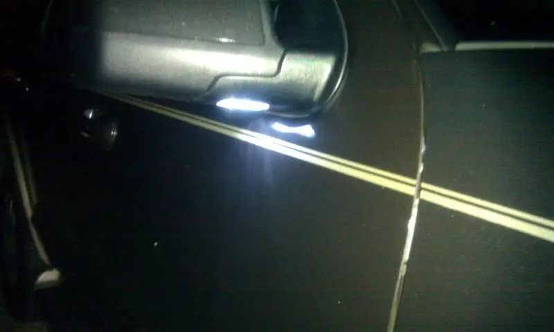

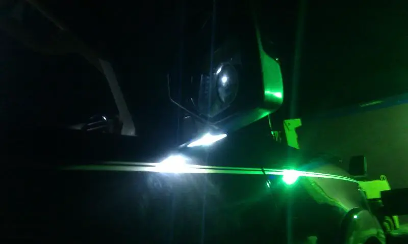

here is a couple of pictures with the LED bulbs installed at night. what do ya think???
