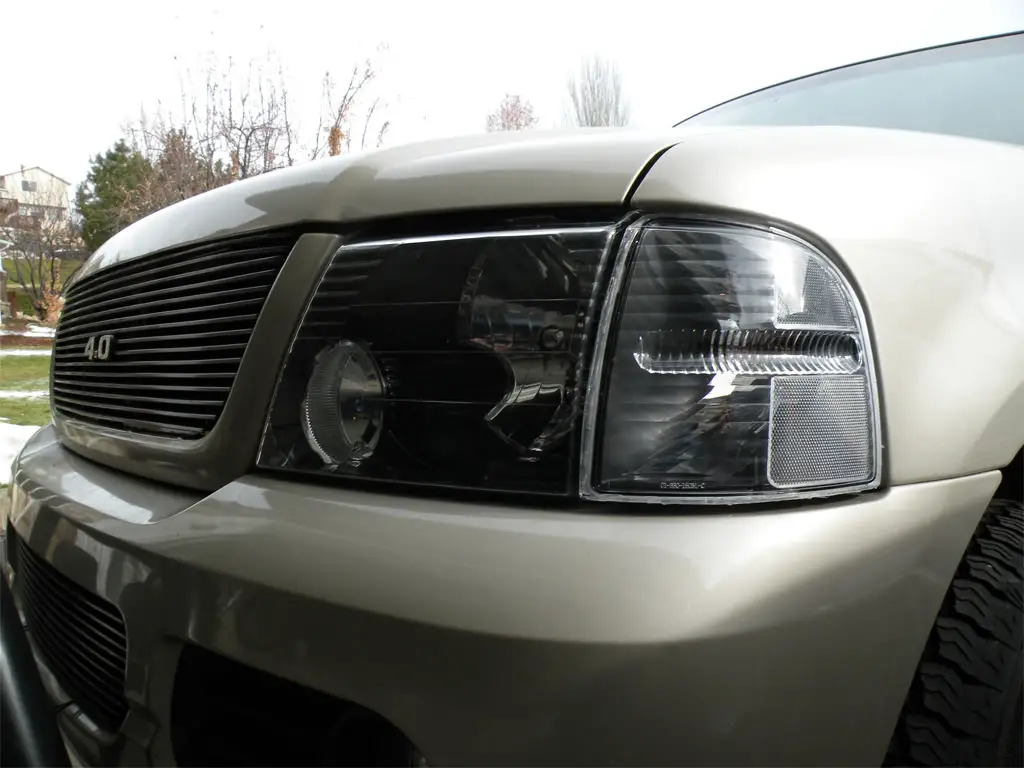

AFTER:
By doing this you have probably saved $80.00
Any questions feel free to ask.
