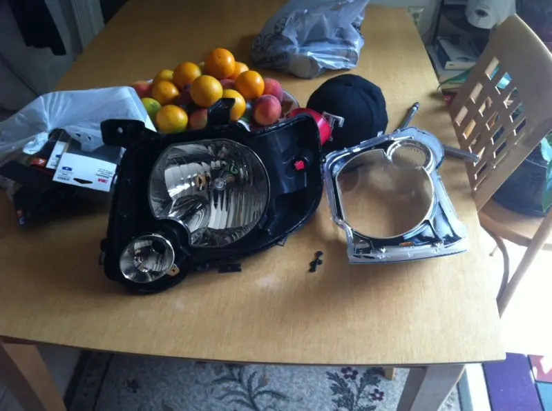

Once the lens if off, there's 2 screws you need to untight before you go further.
This is what it looks like when the lens is out of the casing and the housing out of the lens.

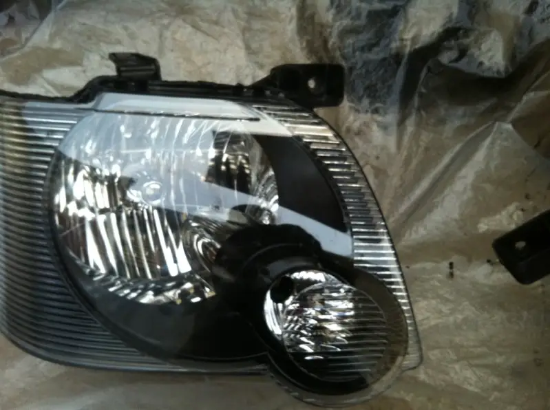

I used black Krylon bonds to plastic spray paint. I layed 3 coats for the housing. The orange reflectors on the side are just held by a small clip.
Once both are done, you put the housing back in the lens and then bolt back the two screws on the picture.

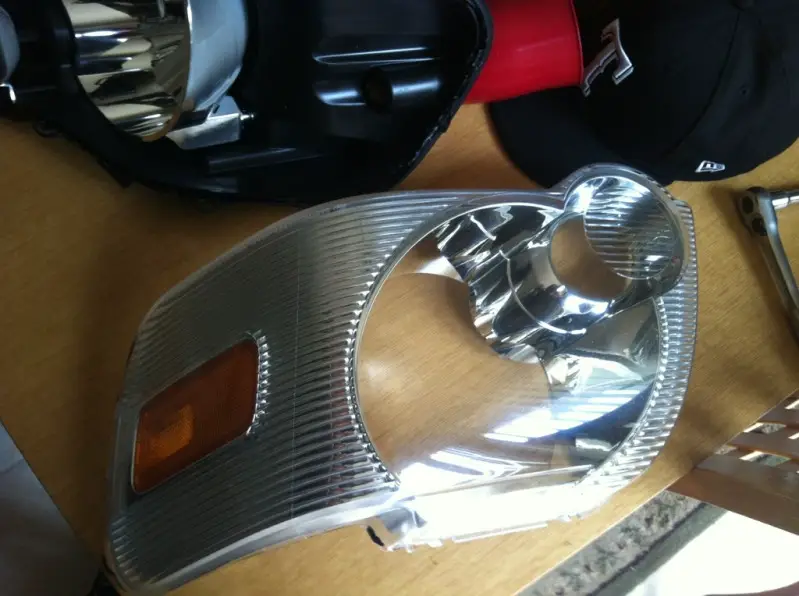

Put back the lens on the casing.
I recommend to take off the old sealant on the casing to help you put back the lens on. You will be able to reseal it after it exit the oven for the last time.
It's not an easy job to put it back on, i'm telling you, but be patient and make sure everything is in place and all the clips are are the right place.

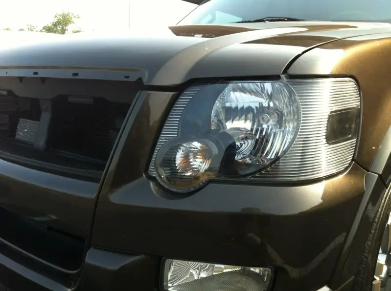

Once everything is sealed and ready, you can put the headlight on the truck and enjoy the look of your new black housing headlight!!!

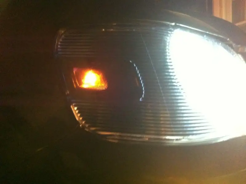

This is the final result!
Hope this helps!.... If you have any questions, feel free to ask!

Hey man, I have to thank you for this write-up. It helped me alot!!!! I painted mine this past sunday and DAMN they came out nice. I even tinted my reflectors and they looked good as well. Great appreciation for this!
