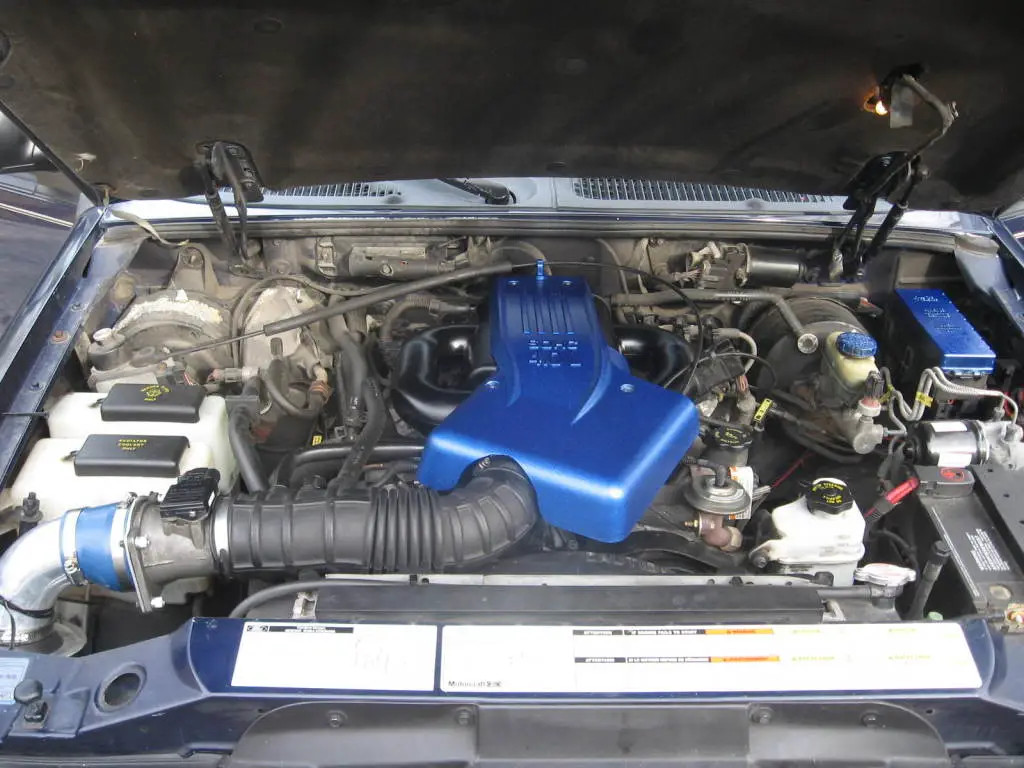

my first test piece was couple things in engine bay

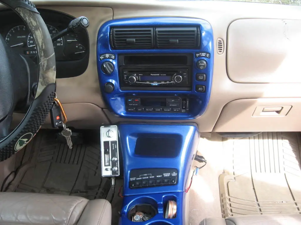

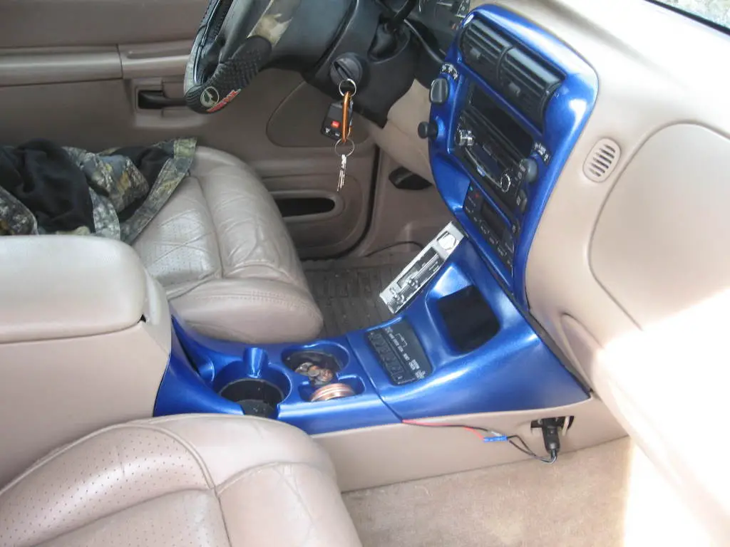

in the car
The whole inside
cup holder and msg center closer
The whole thing from the back seat
