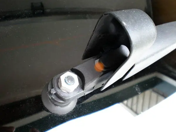

☐ Soak the Nut first, then using a socket one size smaller (10mm nut, use 9mm socket) tap it with a hammer. Do not beat it, you are merely allowing the micro cracks to open. Kroil advertises that it will creep into a crack a millionth of an inch wide. Remove the nut and set it aside.
☐ Soak the stem and socket of the WW Arm. Step away for a minute or two. Using a Rubber Mallet or a block of wood sharply rap the joint (hinged portion). When we do this the windshield is normally cracked. If your glass is good, then don't do this. Instead tap the side of the fitted portion.
☐ Now, you should be able to flex the wiper arm at the hinge and it should come off. If it doesn't (Trailblazers, ugh) then you will need to put a puller on it.
☐ Coat the shaft/spindle with antiseize compound. Place the nut on the shaft/spindle and thread it down far enough to make it flush with the top. Place the puller on it and hook the arms under the wiper arm. Tighten the adjustment bolt half a turn after the bolt makes contact with the nut. Every two minutes, tighten another half turn. The trick here is continuous pressure. It will come off, I promise.
