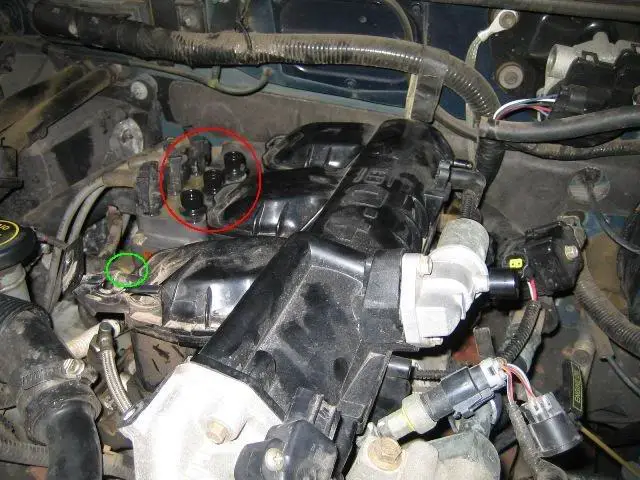

I removed the spark plug wires going to cylinders 4-6 (driver’s side) as the wires are threaded through the intake. I disconnected the wire at the spark plug first, then at the coil pack (circled in the photo below) and pulled the spark plug end through the manifold. Remove the four screws that attach the coil pack to the upper intake. Remove the wiring support for the coil pack from the intake (green circle). Go easy on it, I broke mine in the process :(. Lift off the coil pack and set it aside. I set mine on the passenger side valve cover (refer to the next pic).

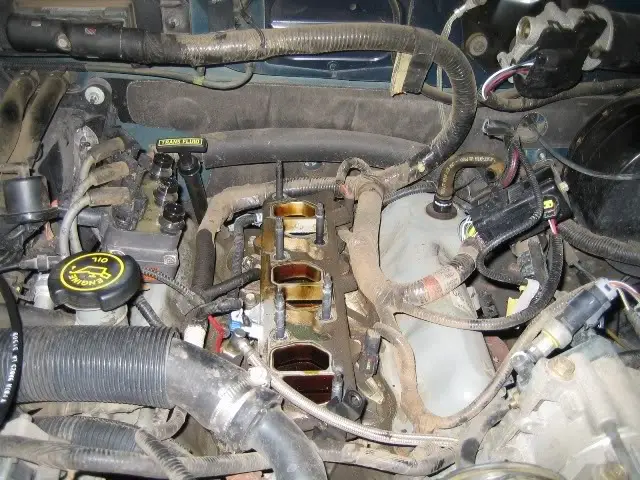

Remove the six nuts that hold down the upper intake. Lift the upper intake up and off of the six studs attached to the fuel rail / lower intake. At this point any connections you forgot will become obvious J.

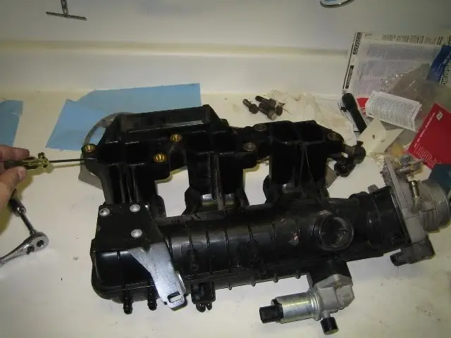

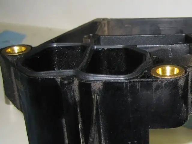

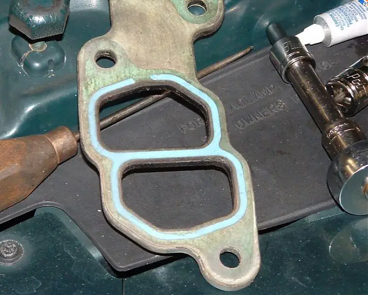

I set the intake on my work bench upside down to replace the gaskets. I am pointing at one of them with my pocket screwdriver. I used a pick to pull the old ones out.

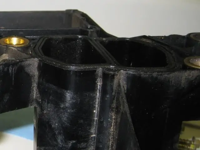

The old gaskets had hardened considerably and were flush with the sealing surface of the upper intake. I can see how this would cause a vacuum leak.
The new gaskets were significantly more pliable and you can see that they protrude below the sealing surface.

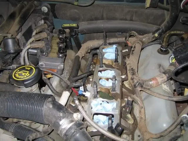

I stuffed shop towels in the intake runners of the lower intake (to keep crud from falling in) and cleaned the sealing surface of the fuel rail / lower intake.

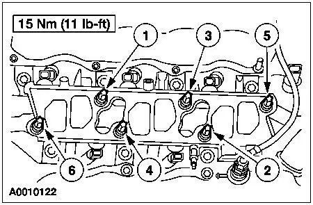

I checked the torque on the intake studs using the Ford manual. This is where you need the external Torx sockets and the torque wrench.

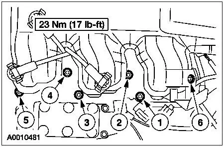

Remove the shop towels and lower the intake down over the studs. Tighten the nuts in the order shown below. I used the e-Torx socket to hold the stud and a crow’s foot to tighten the nut.

After installing the new lower gasket - check your book for the torque rating for these studs, as it differs depending on the year. Torque them to spec and wait a half hour or so and check it again. The gasket will settle.
