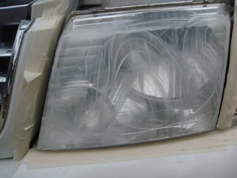

Step 1:
You'll want to moisten the Brown sand paper and the headlight and start sanding, making sure to keep the headlight moist. Apply a small amount of CV #1 to the sand paper along with water to keep the headlight moist. Do not apply more CV #1 if the lens begins to dry, just mist it with water. Make sure that you do NOT let the headlight dry while sanding
Step 2:
Wipe the paper lens with a paper towel to check progress. It'll start to look white and hazy, that's normal. If your headlight is really dull or damaged, and you still see damage, repeat Step 1 until damage is non-existent. If the lens is cleared of damange, proceed to the Blue sand paper using the same process. Remember to keep the surface moist.

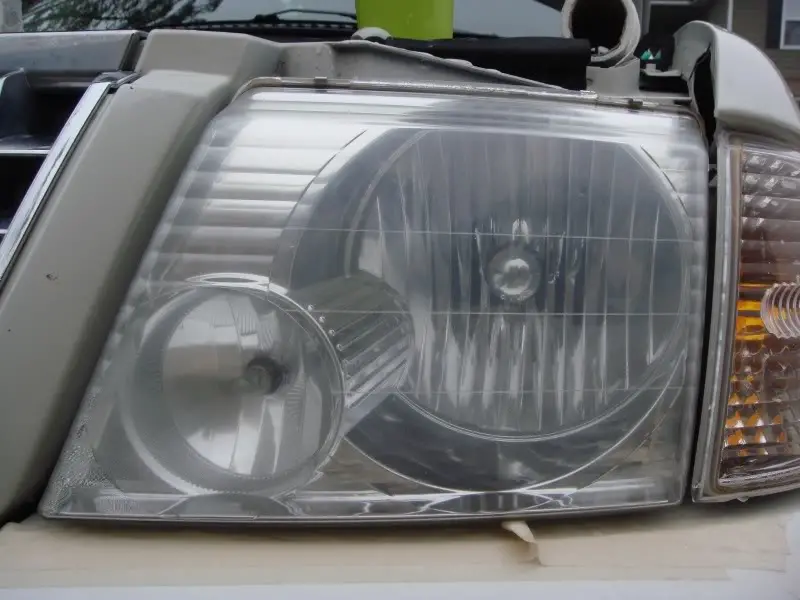

Step 3:
Using the Blue start sanding on the moist surface. Add a small amount of CV #1 again to the blue sand paper. It's very fine and will immediately begin to "slide" over the surface. Once you're done, in approximately one minute, wipe the lens with a clean paper towel.
Step 4:
Apply a pea-sized amount of CV #1 to a piece of the HydroWeave cloth folded twice into a square. Vigorously polish the surface until the product begins to dry on the lens. (About 1 minute) Turn the cloth over and continue to polish until most of the product is removed.
Step 5: Wipe the surface with a damp cloth or paper towel until all residue has been removed, then completely dry the surface.
Important: Damage removal is critical; If it is incomplete, the final result will be less than desired. How much time you put into this will determine how great your headlight will turn out! {On a side note, my passenger side didn't turn out that great, I'll probably be redoing it again}

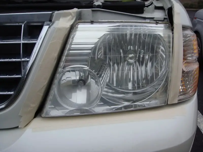

Step 6:
Next you'll apply the CV #2 to the HydroWeave cloths. (Note: There are 4 pouches, use one pouch for each coat applied to the lens. Apply two coats of CV #2 to each lens)
A note of caution: CV #2 comes out REALLY fast, be careful to make sure you get it all on the cloth and not your fingers
Make sure the lens is dry and slowly start to apply the complete pouch to the HydroWeave folded into a square.
Wipe onto the surface of the lens using LIGHT PRESSURE in one direction. Do not continue to wipe the product as it dries If you wipe it while it dries it'll pull the finish.
Step 7:
While the CV #2 is drying on the first lens, go ahead and do Steps 1-6 on the second lens.
Step 8:
Once you've got the coat of CV #2 on the second lens, start to let it dry and go back to the first lens. You'll want to put the second coat of CV #2 on that lens and let it start drying. Remember, if it's cold outside, you may want to use a hair dryer, or turn on your headlights to keep the lens warm.
Step 9:
Repeat step 8 on the second lens, making sure not to pull the CV #2 once it begins to dry.

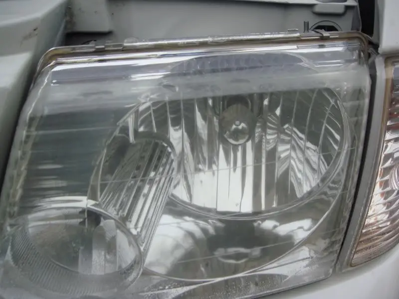

Once the CV #2 cures, sit back and take a look at your brand new headlights for less than $30!
[Note: I've got moisture coming in on both my headlights near the high beam, I may look into just replacing the headlights completely if it doesn't clear up.]
