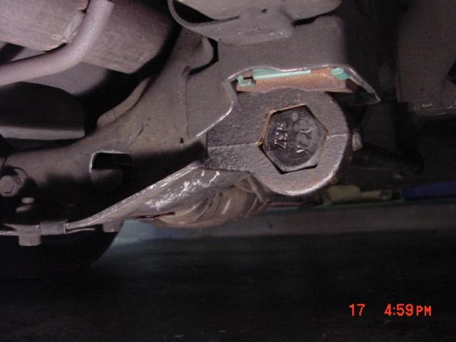

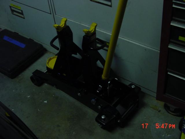

Let's start off with putting your truck on jacks, look for the horizontal frame piece running across the front of the truck, jack it up, put it on stands. This doesn't need pictures. This is releasing most of the tension off your torsion bars, in which, makes a torsion bar function correctly. It uses the weight of the vehicle to function.

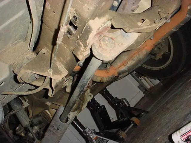

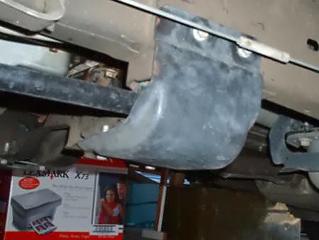

Now go look under approximately the middle of your front doors, and you'll see a cross member connected to the frame. On both ends, you'll see solid bars leading to the lower control arm, this is your torsion bar. You won't see the torsion adjuster until you remove the torsion plates, so go ahead and remove the bolts for them on both sides.

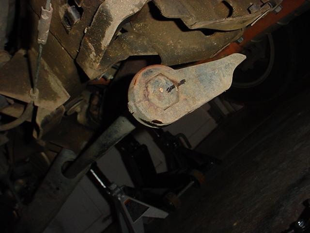

Now you can see the adjuster and how it works, this is where you'll be for awhile, so get comfortable!
Here you have your adjuster in the normal position, what we did here is use a permanent marker to mark the stock position, it ends up resulting in just using an indented line on the adjuster for matching it up (you'll see what I mean). Also, you can go ahead and take your torsion bolts out going through the adjuster plate.

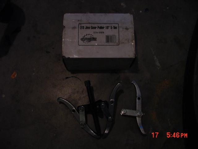

Now, go ahead and get your 2-3 arm gear puller out. This makes this job EXTREMELY easy, and fast. Here's the one I rented from Autozone for a $40 core charge, no daily fees. Part number is 27078 if you're going there!

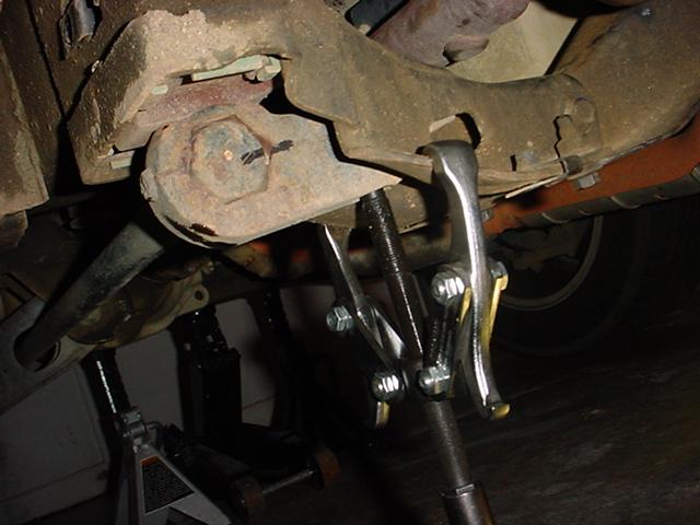

Now you can go ahead and place this up on the adjuster like so, you're going to have to hold it in until it's snug or it might fall. You may or may not want to mark the adjuster, but throughout this page, I'll refer to it. Make sure the bolt in the center is nicely snug in the groove in the adjuster, so it won't slip on you.
You're going to have to "crank" up the arm puller until you're able to slid the adjuster plate loose under the end of the adjuster, and then slowly untwist and remove the arm puller. This is a dangerous part, you have a gracious amount of pressure on that adjuster and arm puller, be cautious.

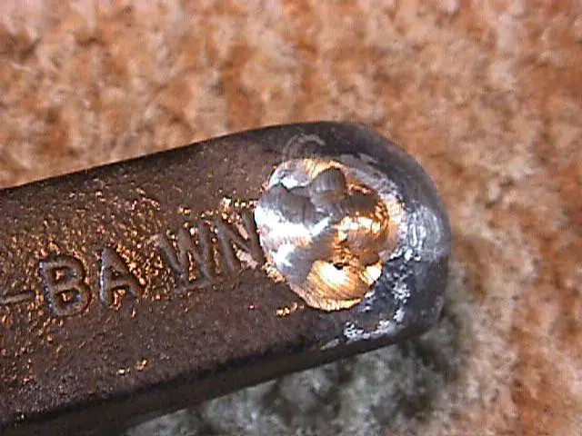

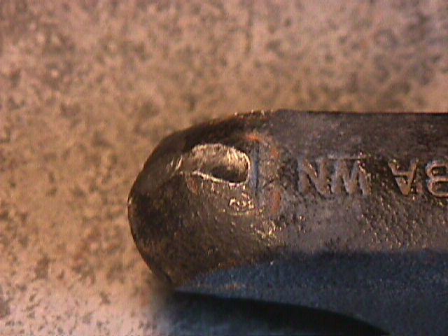

Next thing, is to notch the adjuster. I understand some people don't do this, but I personally had the bolt slip on me without the adjuster notched and took a good chunk out of the pavement. So here's some pictures. I used a dremel, starting slowly, making sure the divot is nice and deep and has no "soft" sides or slippery edges where the bolt could slip to. Please be sure to use goggles while cutting this, metal shavings do shoot around.

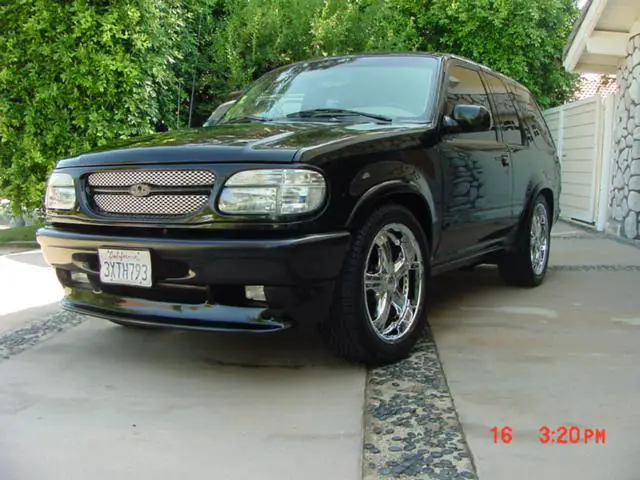

Here are pictures of my Explorer with the torsion adjusters flipped:

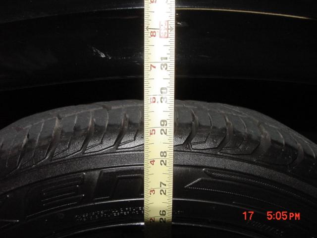

And finally, here's the results, both measurements and looks of how the drop went.
This is the driver side.

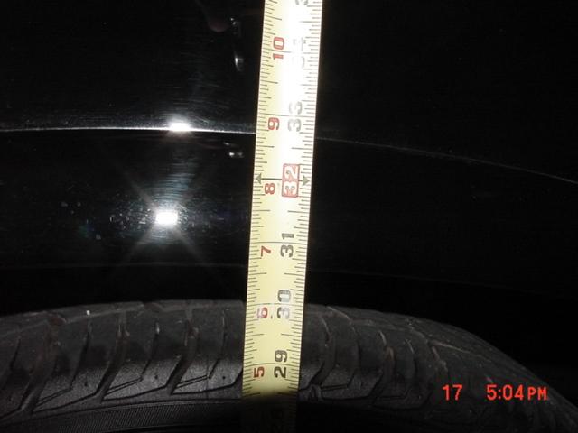

And the passenger side...
As you can see, I got this pretty well on the dot, both sides are extremely level with each other. Now, this WON'T be possible with your bolts still remaining out. After you drive around, see where the adjustment is needed, and put the bolts in the appropriate side, and continue to drive around and correct it, it could either be a long or short process, it varies.

And here's some final results:
