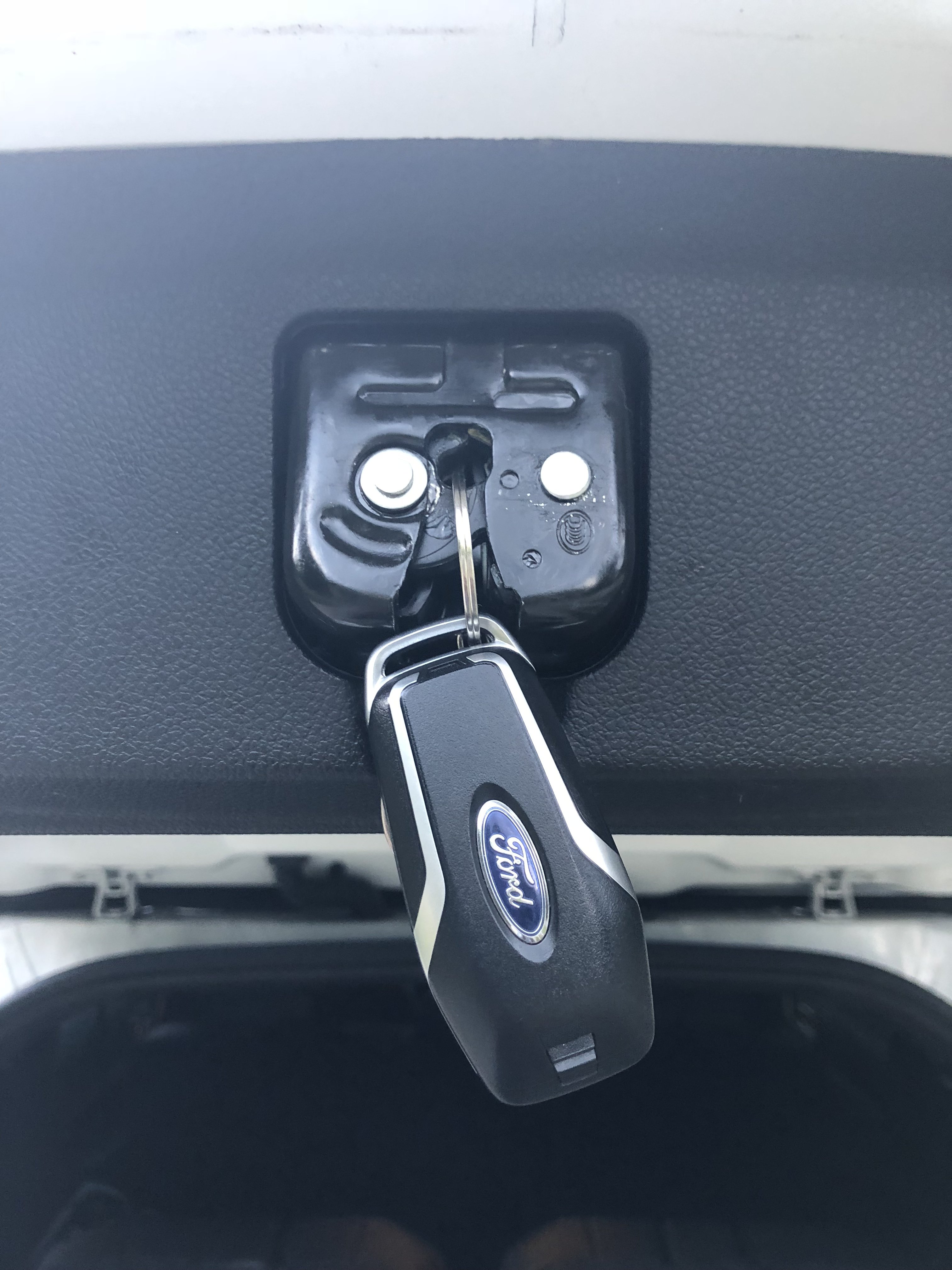

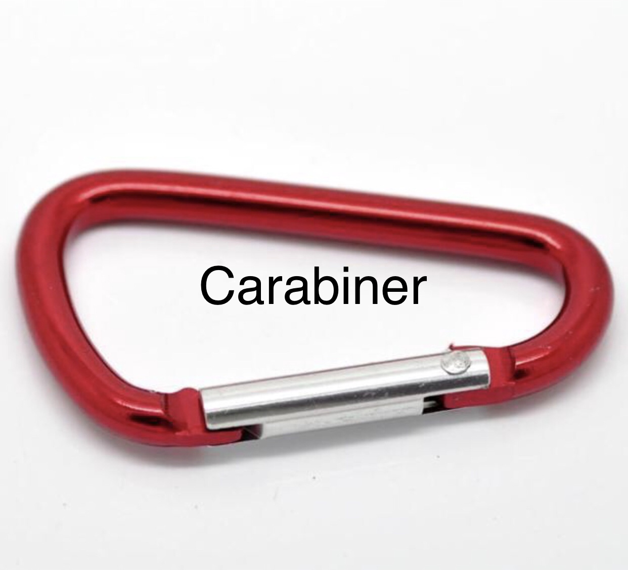

1. Open the hatch
2. push a Carabiner or large key ring into the hatch latch on the lift gate to push the mechanism into the locking position (push upwards) to make the car think the lift gate is closed. **The latch may click once, keep pushing upwards for a second latch until completely latched.
The lights will fade out after 30 seconds just like they do when they time out. After your done to get the Carabiner or key ring out, I pushed the open/closed button on my key fob or inside the car and they hatch latch released.

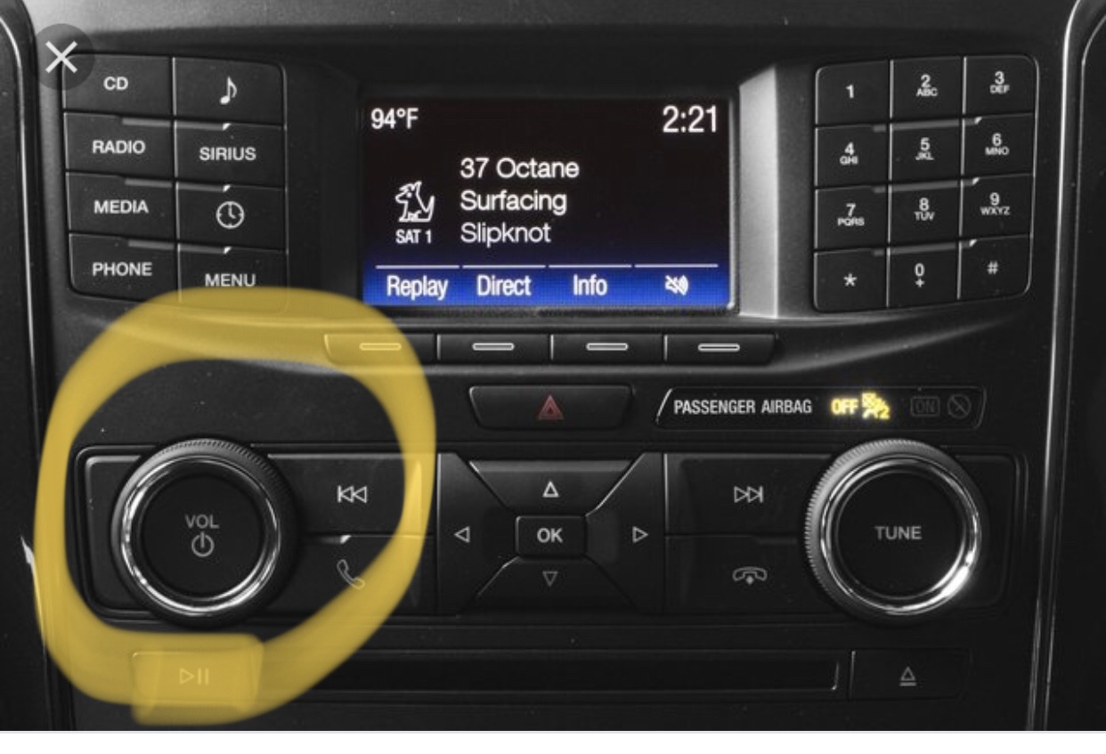

Also another tip*** I have a 2016 Ford Explorer and while at the drive in the radio turns off after it timed out. To turn it back on without turning the interior lights on, just press the circle radio volume button (in the middle) and the radio will come back on.

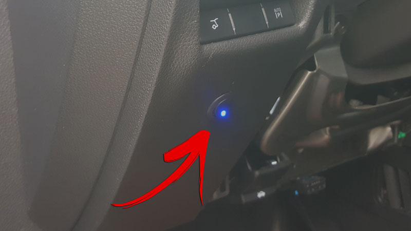

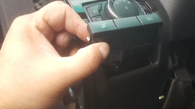

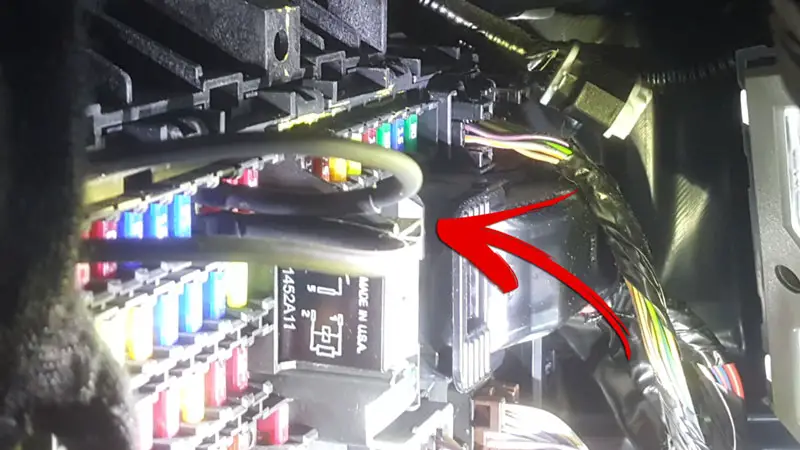

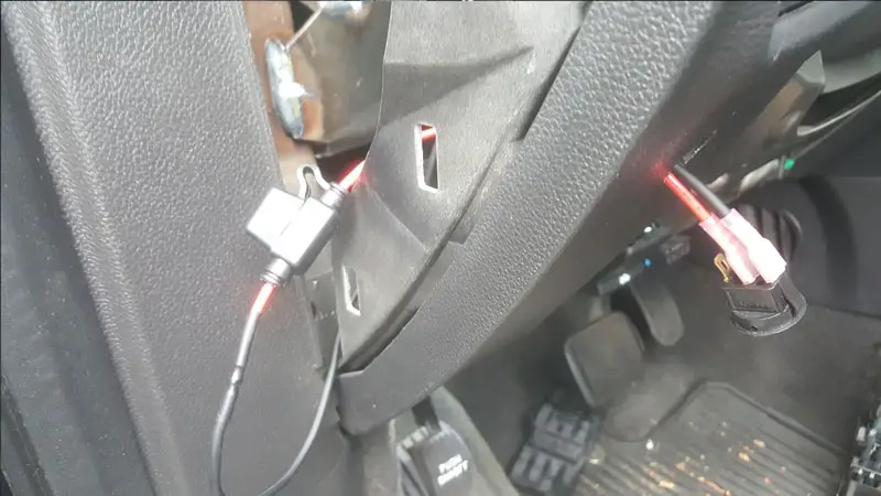

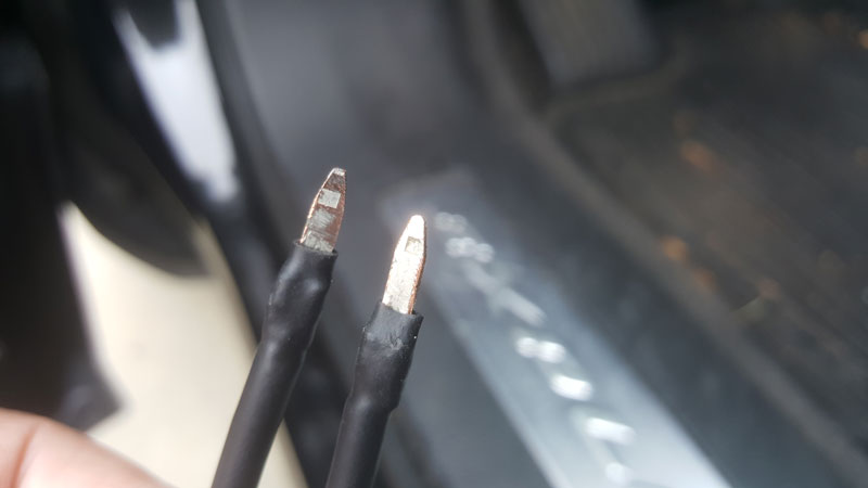

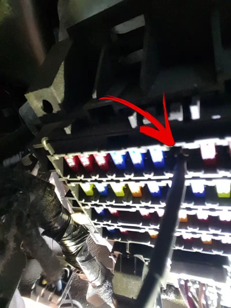

I did a mod for this. Our family also goes to the drive-in movies and the kids camp out in the back with the tailgate up. I tried the rear latch trick, but it was messy(greasy) and unreliable for us.
This mod basically introduces a new switch that "pulls" the fuse for the overhead lights and includes the accent lights that are on that circuit.
Pictures, explained:
Step 1: Manufacture two terminals that can replace the two terminals from the removal of a fuse in the fuse block. Sorry I can't remember the number, but there's a picture to show which one(2013 model).
Step 2: The target fuse location
Step 3: One wire loaded in
Step 4: Remove this panel if you want to put a switch in the blank spot.
Step 5: New switch from Parts Express
Step 6: Both wires loaded in.
Step 7: The existing fuse is now relocated in this fuse holder Fuse holder also from Parts Express
Step 8: Switch mounted!

You have a 6th Gen Explorer. This is the 5th generation forum. The 5th Gen did not have the button you mentioned to turn OFF the interior lights. Once the radio goes OFF, all you have to do is turn it back ON using its ON/OFF button.
Also, there is no need to lock the doors. When closed, the interior lights will go OFF as usual unless a door is opened again. The Battery Saver program will turn OFF all interior lights after 10 minutes.
