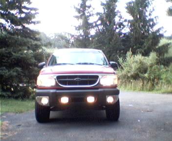

well here are the lights i am planning on getting here is my current setup
how hard would it be to mount them on top of the bumper i know it would bling people cause i have heard that these would be twice as bright as headlights
Those appear to be long range lights. If so I would think you woulb want them on when your high beams are on not w/low beams.
If thats the case you dont want to use the factory switch. You would want to use the high beam wire to activate the switch(that comes w/the lights) so that they would come on with the high beams, if the switch were in the on position. This is so much easier to use in daily driving then having to turn them on & off seperately from the high beams. Also safer for you and on comming drivers who may be cops.
You're making thing more complicated then they need to be. This is actually a very simple wiring setup. Like I said, if you need help...I am right down the road. If not I can explain the wiring. Also, those lights may be too deep to fit on the bumper. I have those and they are about 6" deep.
