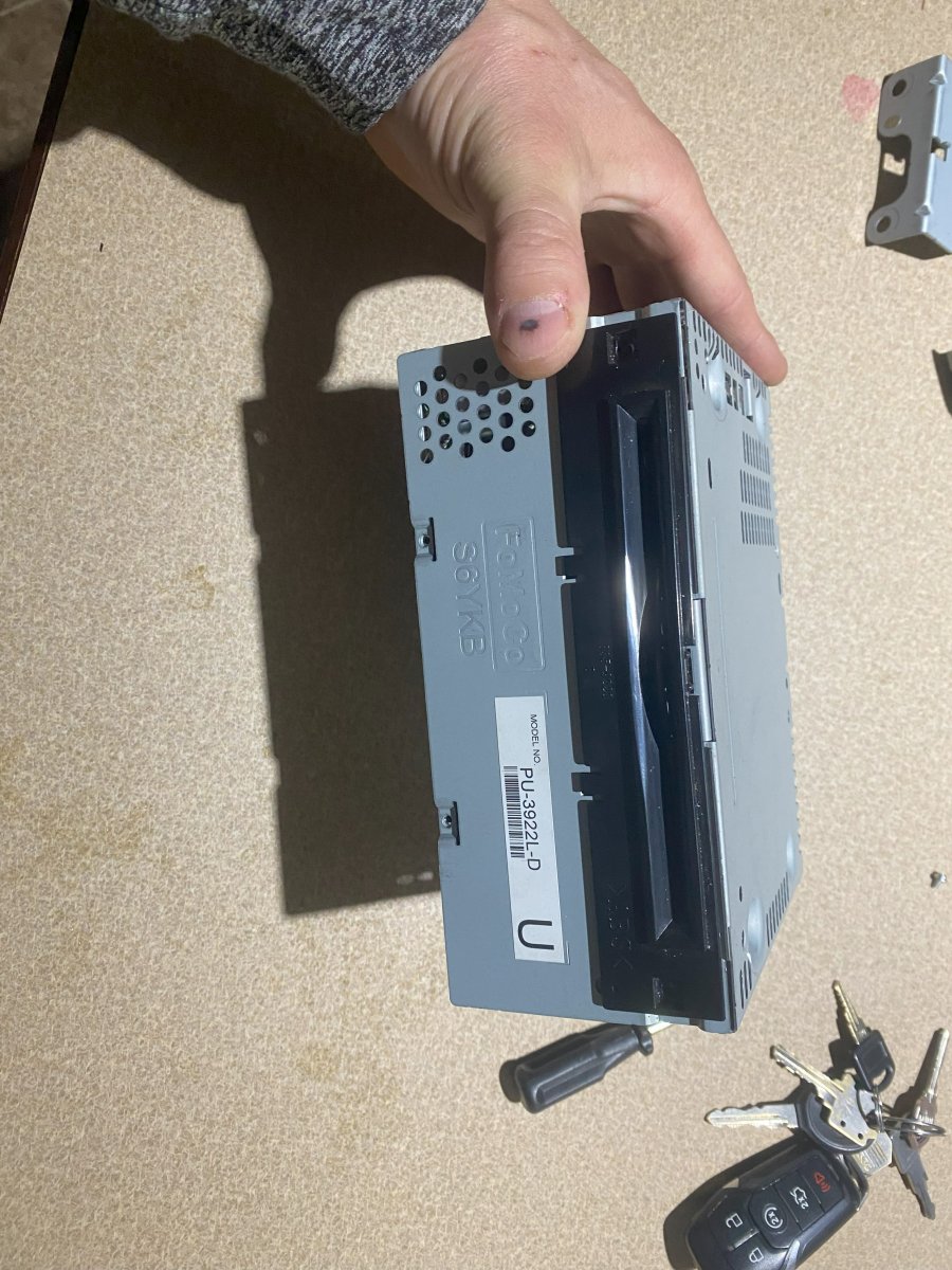

i have a 17 xploder xlt with sync 3 and last year during school my radio started doing what the OPs was doing, volume level turning itself down after 30-45 minutes of listening to music at high volume. new school year and more driving is bringing me back to this because this time its even worse. most times i get 20 minutes or less into the drive and the volume goes from 25 of 30 to what sounds like 5 of 30 and the only way to bring it back is to either turn the music down and wait or just straight up turn it off. to me ( im an apprentice mechanic in 4th period now) it portrays as something that is overheating giving that you can turn it down/off and normal volume is restored after a bit.
got annoying enough that i did something about it. i removed my "headunit" which is in this stereos case the one with the disc drive in it. opening this thing up after removing various screws i noticed that on the heat sink on the side of the board the thermal interface material looked a bit crusty so i removed the 5 screws holding the sink onto the transistors/mosfets. upon removal there was some TIM on them still but looked thinner on some of the sides. i cleaned it off with isopropanol alcohol and some qtips. got both sides as clean as i could and applied new thermal paste ( went to computer store and got some non-conductive paste ). re-installed the heatsink and put it all back together and reinstalled into the vehicle. listened to some music to "set" the paste and confirm that i didnt mess it up.
after letting the new paste "bake" in for a couple days my stereo is able to stay at 25 for at least an hour solid. no plans on making a longer road trip to test how long it can go, so i feel my problem is solved.

Good job there. You most likely got it from what I see in the photos. The original paste may have been either too thick or not evenly spread out. You just want an even thin coat to fill the tiny (unseen by the naked eye) voids in the mating metals. Update this in the future if it holds up. The OP may want to make it a sticky! My background is audio/ video component level repairs dating back to the 1970's. I commend you for taking the time to document this!
