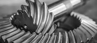

Disregard the appearance of the pinion below. Intent is to show profile, or shape, of ring gear tooth faces. Note they are sloped gradually in one direction, and very steeply, almost perpendicular, in the other. The first is the "coast" side, which transmits only frictional torque through the driveline to the engine, throttle closed. The steeply-sloped teeth show the "drive" side, which transmits the engine's power to the wheels. Coast angle tends to "spread" teeth apart while drive angle "locks" them together. The gearset shown, incidentally, is for the Ford 9-inch axle. A whole 'nuther story exists for front driving axles, in which the role of the tooth shape is often reversed (with accompanying loss of strength).
View attachment 326574story exists for front
