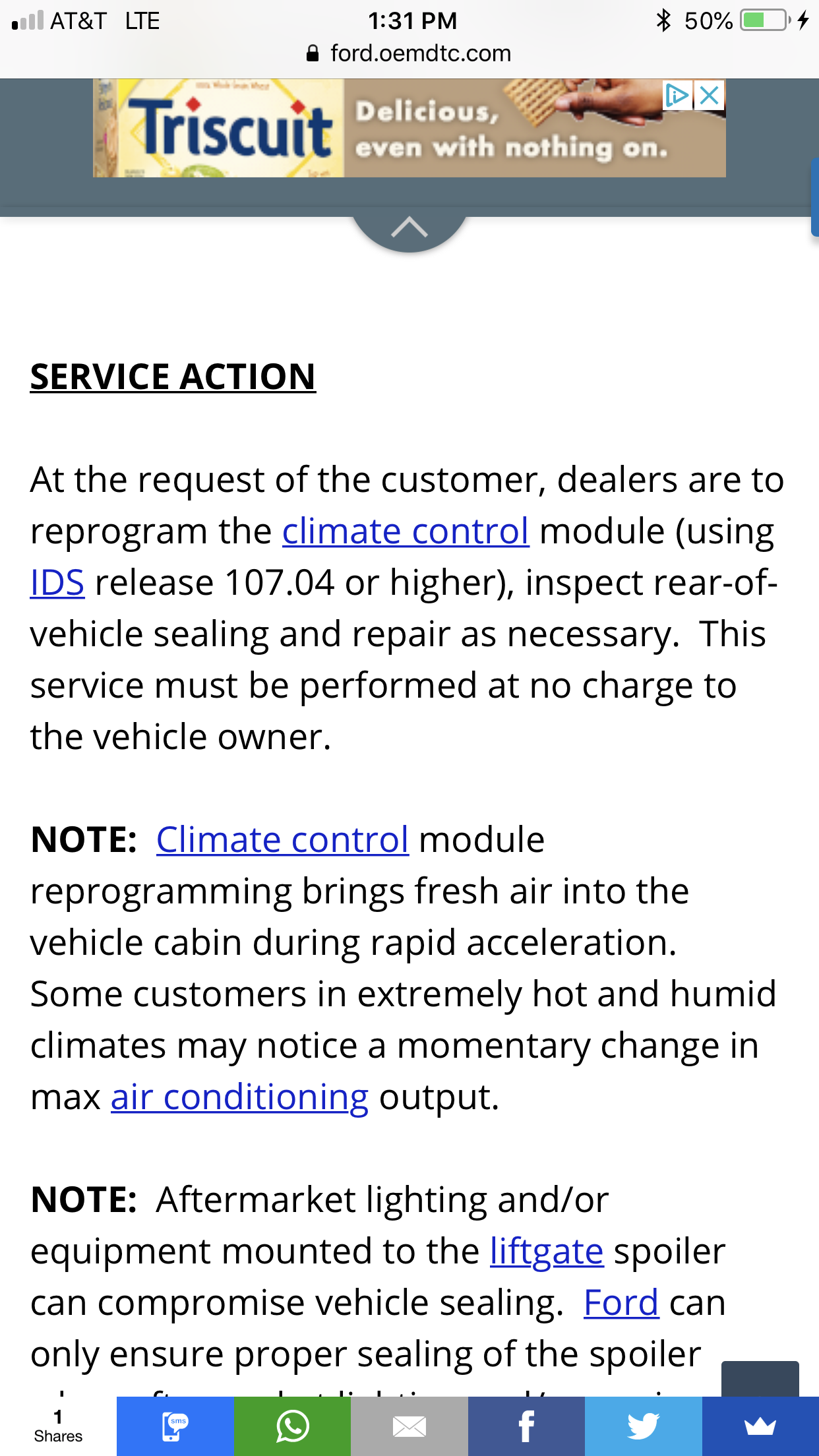

i have 2015 Explorer base AWD with 46xxx miles, tried searching with the issue I’m having not much luck. Dealership told me it’s normal, want to ask if anyone else is having this problem. With hvac off “zero” air coming out the vents. If I give it gas to go uphill downshifting etc, hot air comes out the vents till it shifts back up. The dealership says the engine is taking vacuum from the blend door at high rpm, gives it back after shifting. Still have CPO warranty wondering if they don’t want to touch it without money from me.
