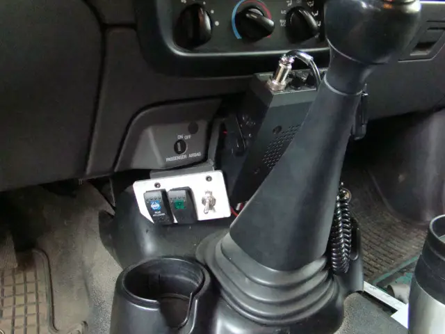

Hey just a useless plug for how I mounted my switches. The plate is 1/4" aluminum with holes milled in it.
