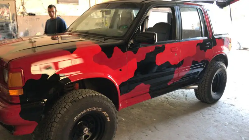

hey! OP hasnt been on for a few years, so you may not see a reply. However, I think they make camo vinyl wraps, which would be much easier than a paint job... however paint jobs are possible! not a painting guru, but i suppose you could
1. sand down (300-500 grit iirc)
2. spray primer
3. mask trim
3. spray base color
4. mask off where you dont want your secondary color or use a stencil
5. spray secondary color
6. if desired, clear coat
however, ive also seen stuff like this done with products such as monstaliner! hope this helps!

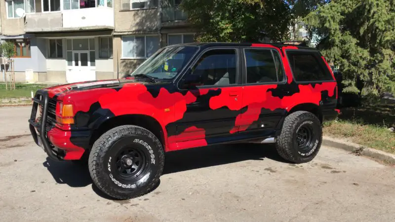

Hola saludos desde Querétaro!!!!
Me encantó el camuflaje 2xred/black.
Me gustaría q me compartieras, q me digas como lo lograste, es decir, el proceso para lograr esa pintura camuflajeados!!
