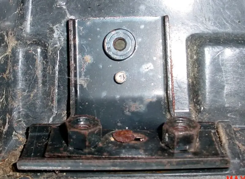

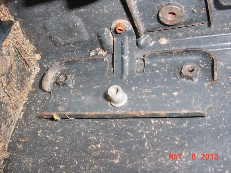

Jerry, the bolts attach to the plate behind the top lip of the bed itself. It's going to be a PITA any way you look at it. If, and I say IF, you can get penetrant sprayed up there that will help. Here's some photos in case that helps you see what you're up against better.
Tie down plates:
Tonneau bracket plates:

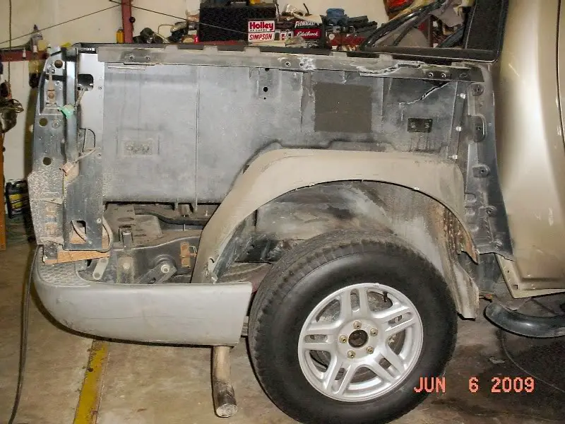

Ok, so I tried soaking the bolts from underneath. I removed the tail lights and t he rightside inner wheelwell and found the the bracket had snapped due to rust and the bolts were totally rusted and siezed to the brakets and nuts.
Next I tried dilling the heads of the bolts off and salvage the hooks but it wouldn't let me do that either. I ended cutting the rear two bed hooks off to get the Tal & Hadas Sport Bar brackets off the bed so I could install the Factory Tonneau cover I bought from Moparmendy from the Sport Trac sitefor $250.
I took all the rest of the bed hook bolts out with no issues and put antisieze on them and the tonneau cover bracket bolts so I don't have to deal with this again.
Now I need to find a pair of bed hooks and bolts to replace the ones I had to cut off.
