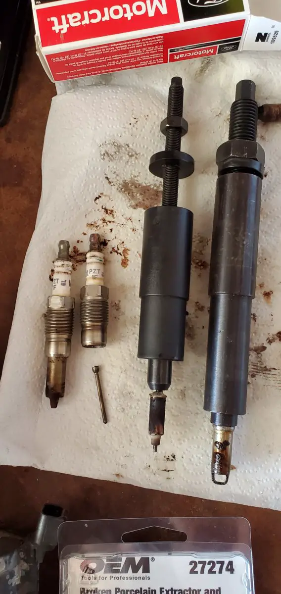

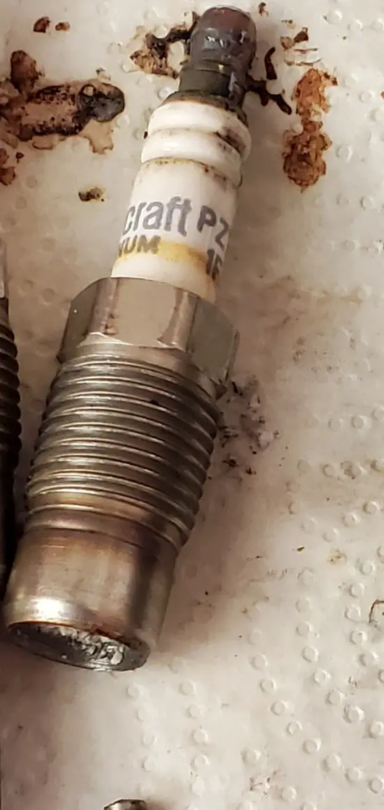

Hey guys, I just want to post about my experience about doing the spark plugs on my 2007 V8.
I have dreaded to do this because of the possibility of broken spark plugs.
I had dealership do it back in 2012 when the car had 86k miles.
I was going to let dealership do it again but they wanted to charge me $500 plus $75 for engine cleaning.
Even the local mechanic shop that I been going to the past 5 years wanted $600 for it...they smiled at me when they heard that I have the 4.6L V8... The lady told me it should not break since I had it done back in 2012.
It is still outrageous to spend that much for silly spark plugs job so I decided to do it myself.

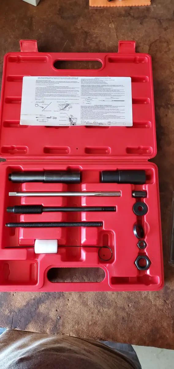

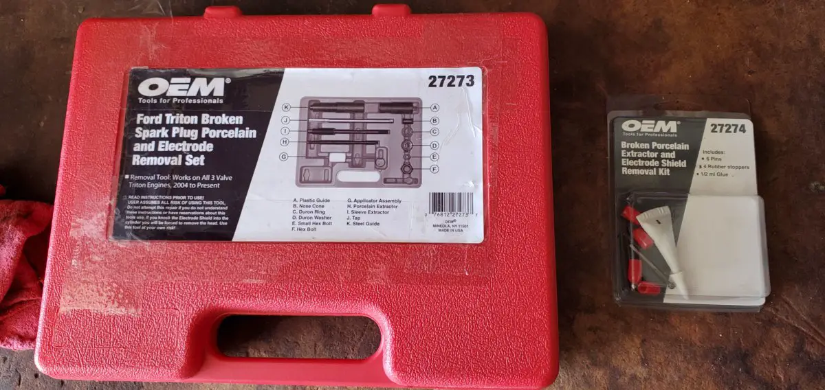

It took me around 3 hours to do them. I used Motorcraft plugs and new ignition coil..for a total of $350 plus the plug extraction tool for $60 just in case...
I used seafoam in gas tank three times (over a month and half period) prior doing the job...
FordTechMakuloco has a video of using impact wrench to remove the plugs.
It worked well. Here the link to the video.
The only problem I had is the plug right in front of the passenger side. I used regular wrench instead of impact since it didn't have enough space for it.
Everything went fairly smoothly..one other issues I had are the wires connecting the ignition coils..I had to remove those brownish colored socket in a couple places to gain clearance. The tabs broke...I still put them back and they seemed OK....but they are not 100% secured. Is there a replacement for it? Or I can just leave them be? I can post a picture if needed.
Thanks guys.
