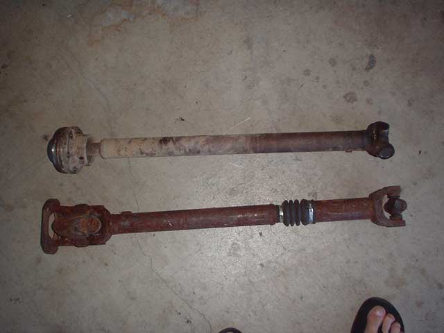

yeah man they are, when i was in the yard there was a 98 & 96 sittin right next to each other and i compared the shafts and they are the same lengths. if i could get my friggin shaft off i would take a pic so you could see, ill still do it but when i finally get it off. suppose wal-mart has good torx bits? ;)
I actually have pics of the two shafts sitting next to eachother on here somewhere.
booyah

Cool, would this mod cut down on some of the slippage inherent in the auto engage transfer case?
Yes, the manual case is gear driven rather than having a clutch like the Control Trac.
