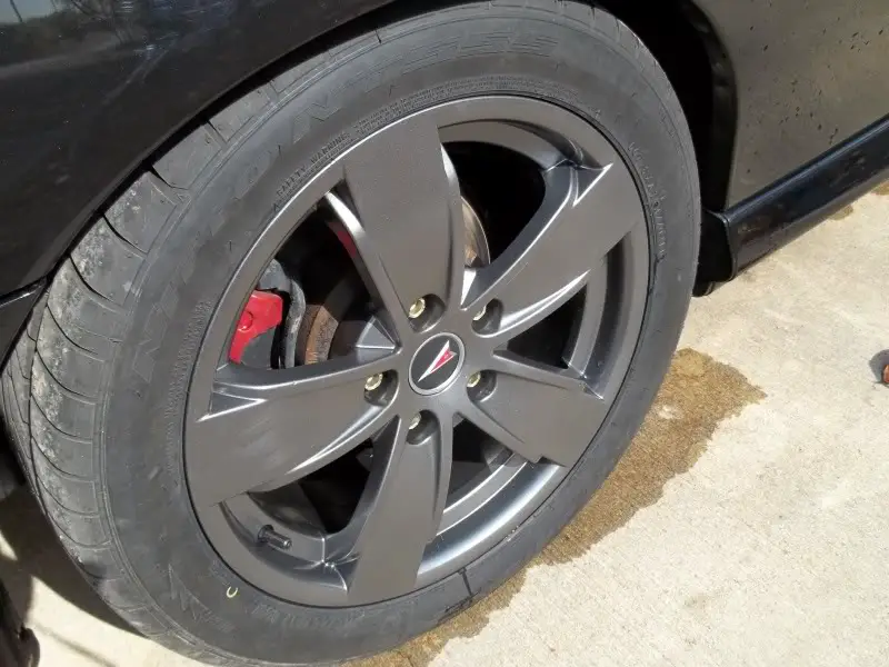

Yes. In fact all metallic powders need a top clear coat.
There are even tinted clears. Check out this color wheel-clear is at the bottom center.
Choose a color and finish to find the tinted ( colored0 clear coats.
Powder Coating Colors
this is clear vision powder over chrome powder over red oxide primer powder. yep, 3 bake cycles. The red oxide is shot on while the item is over 425 degrees, then back into the oven. After cool the chrome, then after cooling the clear, and another bake cycle. > 4 hours oven time total.
this is a satin (40% gloss) over dark argent on my buddies GTO wheels

even with a 1.5 hour soak in a 450 degree oven before blasting, laying on a good chrome base, during the clear coat bake first time around, gasses started bubbling out. I had to reblast the whole set of 20's, and do the red oxide primer, then start over.
any cast material which has been used, such as an aluminum wheel, may be impregnated with impurities which cook out during the final oven cure. The red oxide will seal those in if needed.
