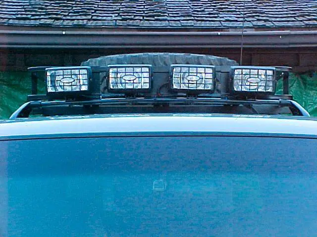

I had mine modified the way Jefe did for quite some time, it was a little flimsy and impossible to keep the lights aimed becaus eyou could only torque them down so much (and that wasn't much) .
I got a conferr roof rack which uses the same tracks as the stock roof rack so no drilling there, though I did drill holes to run the wires through. If you don't want to drill holes for the wiring you can either runt hem through a door (looks like crap but gets the job done) or you can runt hem back to the tailgate and down through there (also doesn't look that great as well as uses about an extra 15' of wire which reduces the power to the lights)
Wow, old post... but yea, I just took the cross piece off and brought it into the house. Lined up the lights how I wanted them and then marked and drilled. You can't tell from the pic, but I also put washers on the bottom to help. The cross bar squeezed together and that was that. Still got them up there.
how do you have all of them wired? Are you still running the stock battery? Cause wouldnt that be alot of strain on it? Did you drill a hole in the top to run the wire?
Yup, stock ALT and battery still... I did drill through the roof to run the lights, but if I had though about it before doing it, I would have just run them down through the rear hatch instead.
Use a roof rack such as the one in the photo on this thread, and either mount your lights to the leading edge of the rack, or to painted angle iron attached to the rack...
