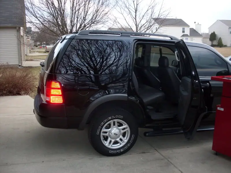

Im not sure hahah. I ordered a case of Krylon Fusion black paint online, and only used about 3 cans. With fusion you dont need to prep and sand the plastic down since its made to bond to plastic, which is nice. The side trim on the doors I painted right on the car, and taped off the surrounding door pannels so i didn't get overspray on it. I took the bumpers off and hung them with wire from my garage door beams to make it easier to spray. DIY spraybooth.. ftw
So I went ahead and went with the krylon fusion this weekend...
It went pretty well, although painting in my garage wasnt very condusive due to the lack of light...there are a couple spots that need some touching up on the front bumper...
Im going to finish my fender rim tonight...Looks pretty good in my opinon.
Bumpers came off real easy too...
