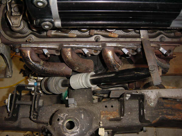

I'm sure Jon is right in that nothing will be really close, all of them will require a lot of work. Figure on removing the collector in a way that you can cut it off and reuse it, moved etc. The left two rear primaries surely will have to be cut off and reshaped.
The best you can hope for is that only one or two pipes from each side will need rebuilding. Cut them off and use other piping to run them around the steering shaft etc.
Ford did a fine job placing the frame and suspension in the path of headers. Then they stuck the steering shaft right down the throat of the #7 cylinder outlet space.

Here's what most aftermarket headers could look like after you cut away all of the pipes that interfere in some way. Then you have to figure out how to reroute the pipes around everything in a new way.:(
